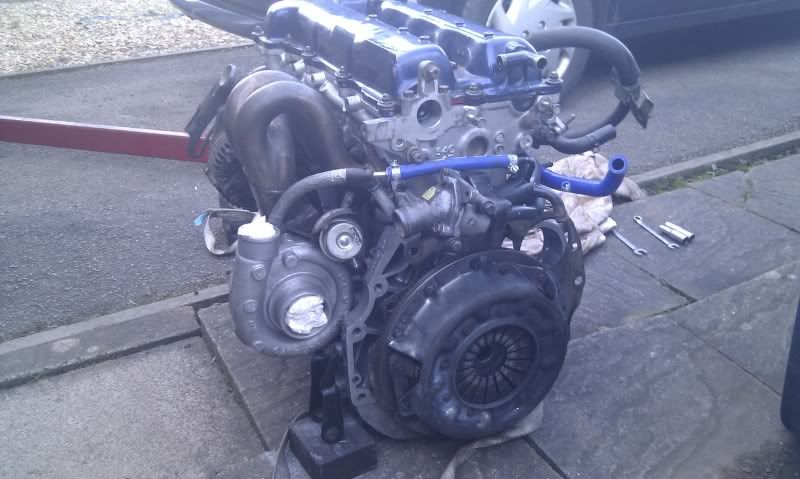

It's all been chemically cleaned, would never have an engine blasted as I've seen what the grit does to engines if you don't get it all out!
I've had some work done on the exhaust ports but left the inlets alone.
2.4 litres of power there! nice mark very nice, the porting will work very well too.
