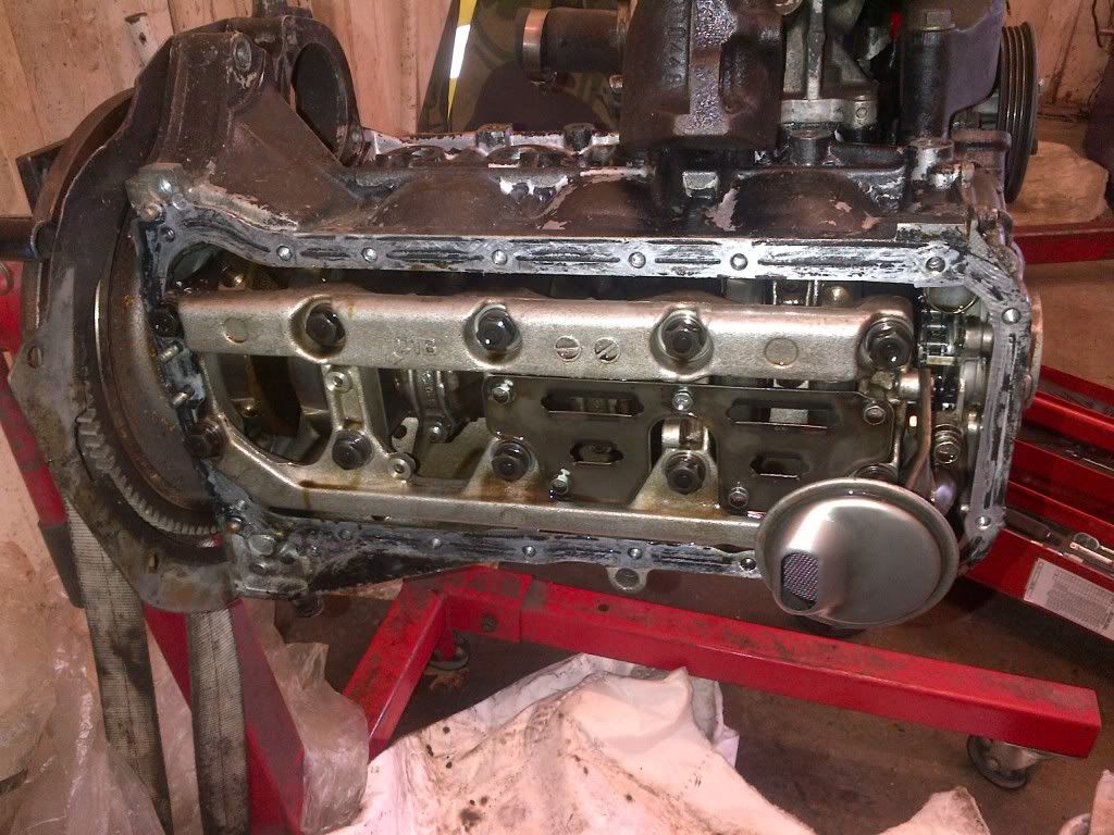

YOU NEED TO USE 2 BOLTS THAT THREAD IN TO THE PAN TO MOVE IT OTHERWISE IT WILL CRACK.
And remove the oil pickup too, and the 2 10mm nuts behind the black inspection cover.
just take your time, the first one is always a git to remove.
bensmith907
Ha Ha. it'll come off first time when you get that sort of abuse!
Havent got those bolts going into my gear box is there any other bolts I can use?
done well if its done 15k since rebuild
yeah dead right it has done well seeing as its been on track and at nurburgring and cant be answerable for detting.....was only a stock build so thankyou martyn : )
bensmith907
As predicted the oil tray came off straight away this morning, its amazing what a bit of banter can do! I didn't have the bolts from the gearbox so I used some from the alternator bracket

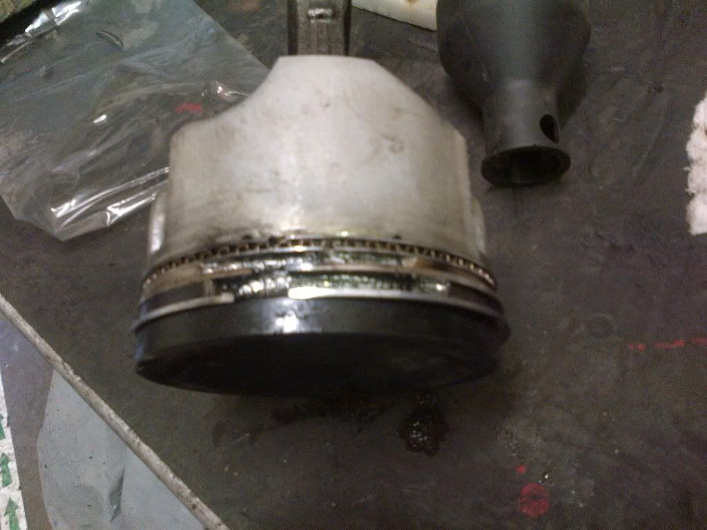

All those who said ringlands couldn't have been more right. This is number 3 piston, Both ringlands have about two inchs of damage. All the other pistons have simular damage too so I'm now in the business for some pistons!
pulsar_stu
What are the bores like?
When we opened mine up we were lucky the bores were ok, the ringlands were the same as yours tho.
What you going for? Forged or standard?
