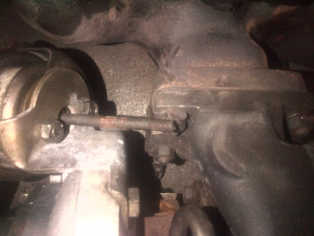

Cock it. You spoke too soom mark- just snapped the turbo actuator arm trying to adjust it. Crappy thing!

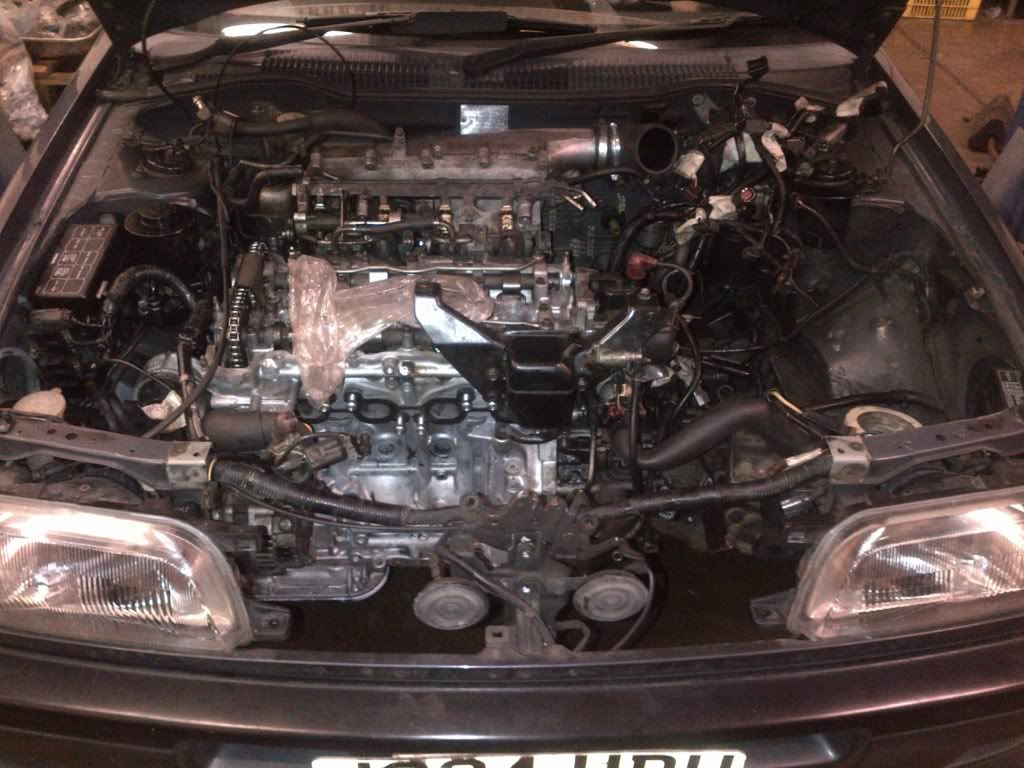

All done. I had a few issues along the way-
Snapped the turbo actuator arm- not a bad thing really as I suspected the old one wasn't up to the job anymore! Owen developments sorted out my turbo within hours of delivering it by setting up a new forge actuator on it.
When I went to start it up the starter turned once or twice then there was a spark and a puff of smoke came out from the engine (head in my hands at this point as I was worried about all sorts of wiring problems) but after a quick inspection it turned out that the engine earth thread on the thermostat had been stripped- quick tap and a bigger bolt and it turned over perfect
When warming up I went to clean something and when I came back there was a massive water puddle on the floor :( turned out to be the water feed for the oil cooler (I didn't fit the clip on properly I'm ashamed to say) what a twat that pipe is to get to!
All in now and I just done a compression check which came out at 167, 168, 166, 169 which I'm happy with.

Did you manage to get the forge actuator on nice and tight on the wastegate flapper?I had to space mine out on the bracket a little to get it tight enough, can't see any one your photo.
stumo
it should be adjustable, if you can't shorten the rod then cut some of it off
bensmith907
I took the turbo to owen developments who are just down the road from me. They fitted and adjusted everything for me.
