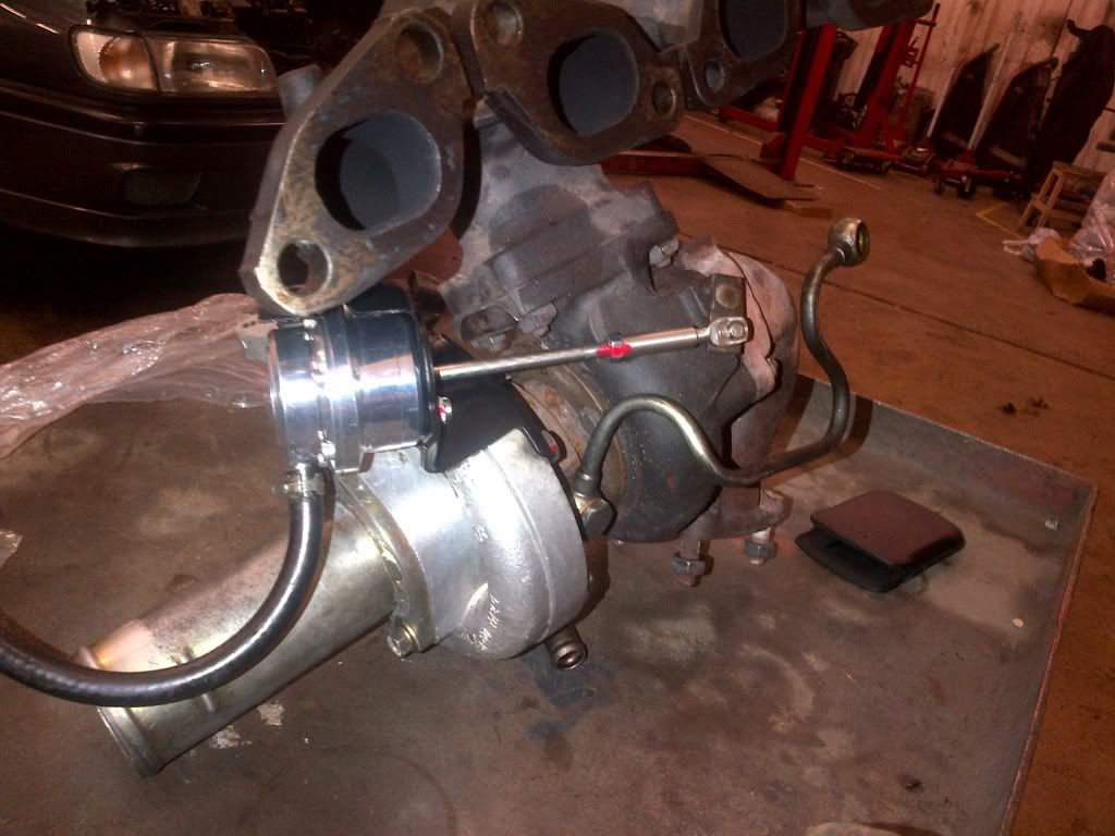

meant to say that the snapped actuator has done you a favour....you can get different springs for it (if you haven't got them already), you can also make it dual port if needed.All done. I had a few issues along the way-
Snapped the turbo actuator arm- not a bad thing really as I suspected the old one wasn't up to the job anymore! Owen developments sorted out my turbo within hours of delivering it by setting up a new forge actuator on it.

stumo was explaining that the other day; if you've got two vacuum/boost hoses on an actuator, you can prevent wastegate creep. - Until you reach your set point you can use the boost on the underside (?) of the diaphragm to keep it shut, then when your boost controller lets pressure go to the top (?) there is equal pressure on both sides and the spring pressure alone will open the wastegate. As a result there's no partial opening of the wastegate on partial boost, so you reach your set point faster.Dual port? Ill look that up some time. I have much to learn!
Yeah I cut a bit off but the thread doesn't go far enough up the rod to just cut it to the right length so I spaced it with 2 nuts, which pulled the rod away from the flapper and left enough thread on for it to work.it should be adjustable, if you can't shorten the rod then cut some of it off

Do you know what spring they put in your actuator?I took the turbo to owen developments who are just down the road from me. They fitted and adjusted everything for me.
I reckon you have the yellow spring as i still have mine on the 1bar loop and getting 1.2bar with the forge actuator and yellow springRight I just adjusted the pipe work for the 1bar loop which im guessing doesn't work with an uprated actuator as I got 1.2bar....

I think it also answers another question- the spring is obviously the blue one running at 18psi
