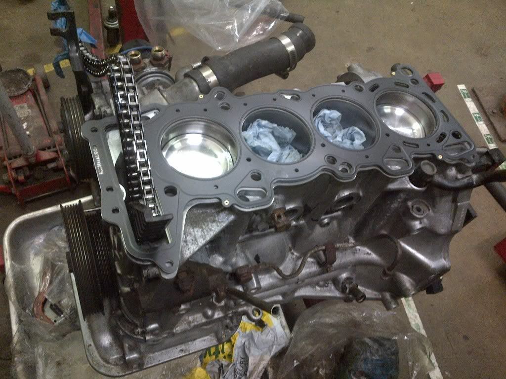

anyway I spent yesterday modifying the cosworth head gasket two hole reamed satis!

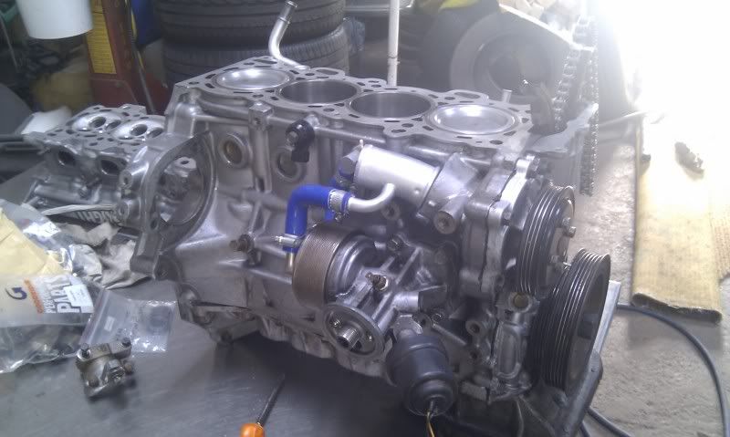

Not a big fan of braided lines. The lines on the block atm are the ones that came off my other engine, they will be swapped back for cleaner sold pipes when I swap the engines over again. Would be interested to hear how reliable these braided lines are on cars?
The main advantage of the braided lines is that it makes it a lot easier to get the turbo on and off; you can just line it up, bolt it down, and connect the lines to the block. With the steel lines you have to try to keep those all lined-up as you put the turbo back on.

At the moment you're ahead of me with yours, I haven't enlarged the holes on the cosworth gasket yet. I've actually got my head though so will be building it today and getting it back on later hopefully.
I can understand that those lines are a right twat to get right. On that note off the top of anyones head does anyone know the Internal diameter for the copper banjo washers on the turbo lines? I seem to remember it being bigger than what my motor factors could offer
It's all been chemically cleaned, would never have an engine blasted as I've seen what the grit does to engines if you don't get it all out!
