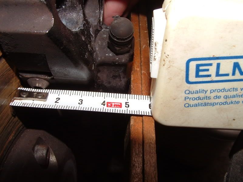

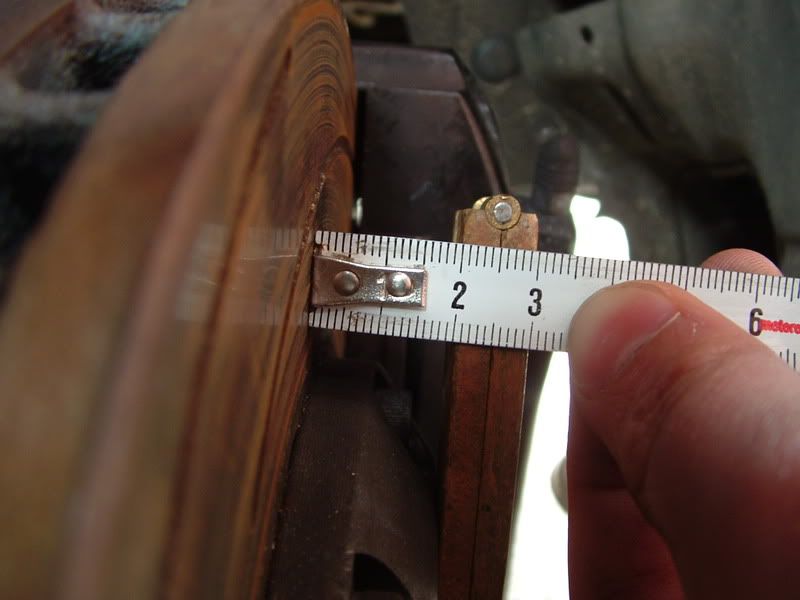

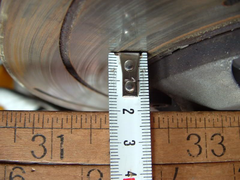

So then I will try to explain again this time by using a picture and text:
Measure no 1:
Remove the wheel and put something at your own choice that is flat on top of the bell. Then measure the gap between this and down to the surface of the disc, marked with 1.
Measure no 2:
Put something at your own choice that is flat on top of the caliper. Then measure the gap between this and down to the surface of the disc, marked with 2.
Kev told me that the bell is 6mm thick.
Now with these 2 measures I can compare the same measures on the original parts and see if this will fit with my alloys or not :-D

Right, well I’ve measured what I believe is what you requested. Not sure if that’s going to help you at all?
Measurement No:1
Measurement No:2

fubar andy: thanks :thumbsup:
The original measures are:
dell to disc: 19 mm
caliper to disc: 32 mm
-> these calipers will need ca 20 mm more space between caliper and alloy
I have a 20-22 mm gap today (because of spoke-design) so this will be a tight fit, but will hopefully be ok without the use of spacers :-D
