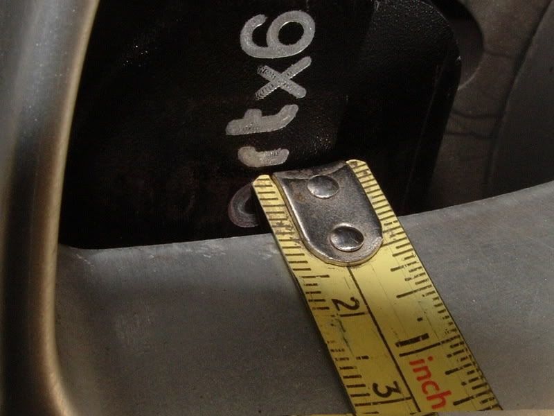

fubar andy said:
...and with a little bravery it seems to have worked. They were very stiff to tighten so I slackened them off and wrenched them up as tight as it could go. There was a few creaking noises when I did it :? but it seems to have done the trick. :)
Also an image of the gap from calliper to alloy (8mm)
What was the gap from calliper to alloy when using original caliper?
John
Rune_GTI-R said:
fubar andy: What was the gap from calliper to alloy when you were using original caliper?
Chances are he may not know (sorry if im wrong Andy) as he upgraded from Wilwoods to the 6 pots rather than standards to the 6 pots.
Rune_GTI-R
Hmm ok.
If he or any one else could measure the distance between the outer surface of the bell to the outer suface of the disc and then from the disc to the outer surface of the caliper, then that would be VERY helpful :-D
And then I would now if this kit will clear my alloys or not...
Not it’s ok John, your right I had the Wilwoods before I had the 304mm kit. When I acquired the car it was the 1st thing I bought for it! :roll:
So I can't really help on this question, however what offset are your wheels?
I have 7,5 x 16" BBS Postert Tuning wheels, ET 35 :)
Are there any chance that you could take the measures that I asked for in my last post?
