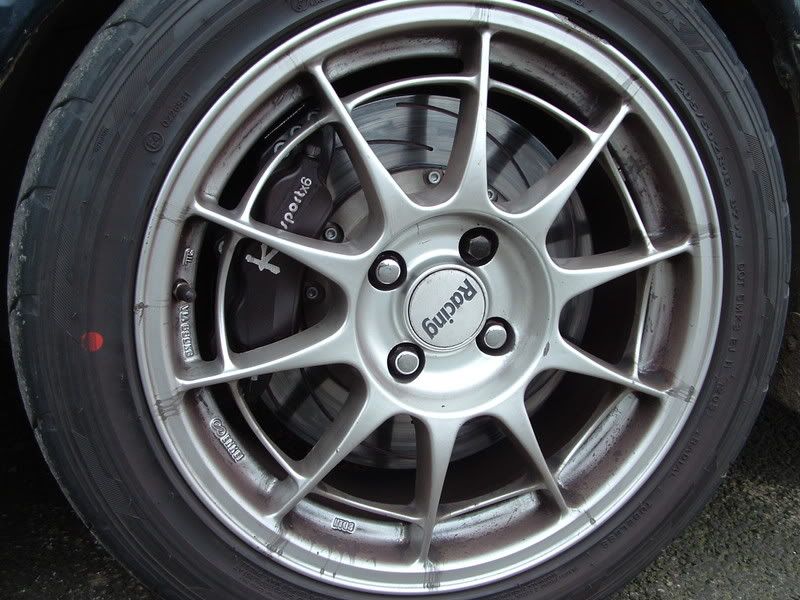

Well I’ve come back in one piece and with a working set of brakes. ;-)
As Cadwell Park goes, I’d say its one of the more technical tracks you can drive on. It really tests you as a driver, your cars suspension as well as its brakes and other areas.
I normally spend most of the year sorting out problems on my car, suspension bits and trying out brake compounds. Once I am happy I’ll head to Cadwell Park and give it death. Normally it will show you what’s still wrong with your car and what’s failing. :oops:
So let’s see what Cadwell Park makes of the K-Sport 6POT brakes: As I’ve only been able to bed in my pads over 36hrs it’s been a bit of a rush to get them ready, but a nice drive down to Cadwell gave me time to sort that out.
So the big question is, are they any good?
Yes, they are! :)
As I’ve mentioned the build quality is good and installation wasn’t too difficult at all. I still have the problem that the bolts for bolting the bracket to the hub were the wrong size, but I’ve had to use my old Wilwoods ones for now.
Although I spoke to Kev about this, he pointed out that the bolts are threaded to pass through the hub holes to screw into the bracket (like an AP Racing calliper) once tightened they should stay put.
Personally I found it disconcerting is that there is not nut to thread onto the bolt unlike the Wilwoods. I think that since I’m used to that with the Wilwoods, I feel more comfortable with that set up than what is with the K-Sports (I’ll take some pictures to clarify). Even if I had the right bolts I would probably go out and buy some hardened threaded bolts and nuts for my own personnel comfort and reassurance (recreate the same set-up as the Wilwoods).
With that covered the actual performance of the brake kit is excellent. It took me some time to learn how they react to hard braking and that I can leave it later until I applied the brakes.
Under hard braking the peddle feels strong and I had good confidence within the kit. (Also I’d like to point out that I was also using a servo support bracket make by Mr Steve Pudney)
From 110mph down to 60mph I was very pleased with its performance and it shed the speed quickly without any problems. :)
Heat build up was also a major thing for me and I’m glad to say that I had very little problems with it. It did take around 10 laps of heavy braking to feel the peddle going soft, but I must admit I purposely went out to make that happen. Even with the peddle going spongy it was only slightly and I still had excellent confidence within the kit when it came to braking. Was just a case of pushing a little harder on the peddle to extract that extra performance. I’ve also stripped out my car and only has two OE seats (soon to be one Sparco seat when I fabricate my sub frame), dash and door cards remaining, so it has less weight to hump around with it too!

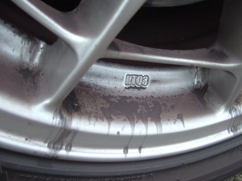

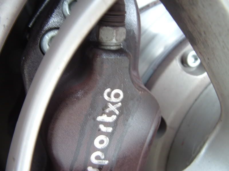

One other thing that I noticed was that the bleed nipples were leaking a little fluid from the threads.
I have tightened them up quite a lot, but I didn’t want to shear off the actual nipple itself which I have done in the past on my Wilwoods. Over the day I only lost a few ml of fluid, but I was enough to notice on alloys and calliper.
I might look at tightening them more or take them out and wrap a little PTFE tape around the threads for added sealing.

Just to add about the bleed nipples. These are on a tapered thread so dont over tighten them as like you say they will snap, i always hate tightening these up as they are so fragile.

Leaking calipers is a big problem as, brake fluid is a very effective paint stripper ! :shock:
Paul
Yup, plus do you really wanting to be flying around a track knowing that your losing brake fluid by the second? :shock: :doh:
Paul
Not if you're using Mintex racing blue ;-) , But I don't think it's a very good idea to be losing fluid :doh: , Hopefully the ptfe tape will cure the problem ;-) .

We have never had an issue with leaking nipples, I hope they just need a little more tightening, I wouldnt be happy if they needed PTFE.
I’ll look to see if I can tighten them anymore, but I’d rather not push my luck as I’m fed up of sheering off nipples and having to drill them out. As Ant pointed out over tighten them and snap!!!
