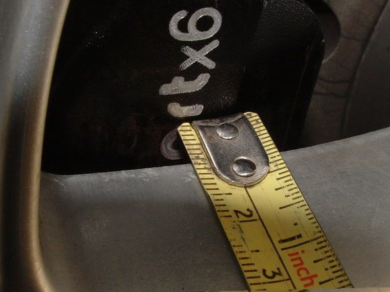

Also an image of the gap from calliper to alloy (8mm)

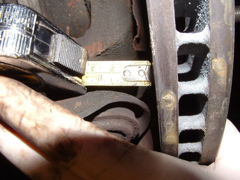

gap from disc to ball joint

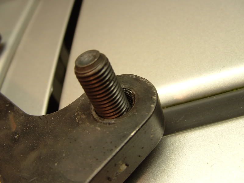

and as mentioned before about the bolting the bracket to the hub, the bolt is a little too small in diameter for the hole but this can be changed :)

There's no torque specified for the bolt either? That would be helpful during installation, I'd think.
Kev@Apex
So modifications needed are:
1) a Torque setting for the bleed nipples
2) a M10 bolt rather than the M8 one supplied (feck knows how that happened ????)
