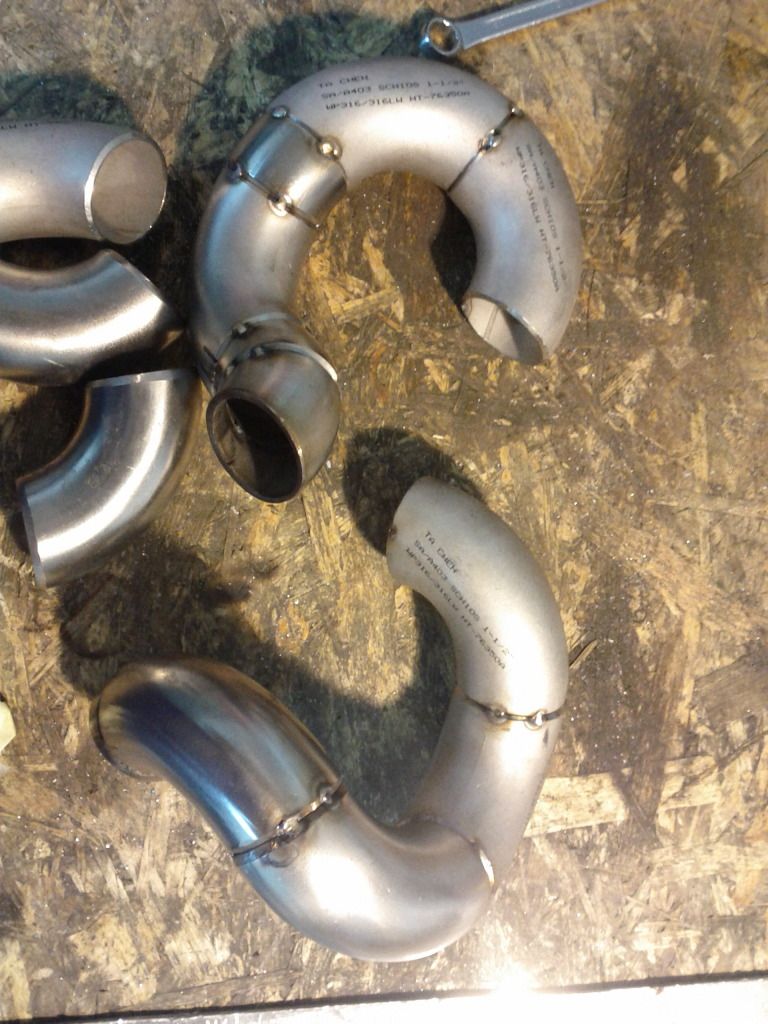

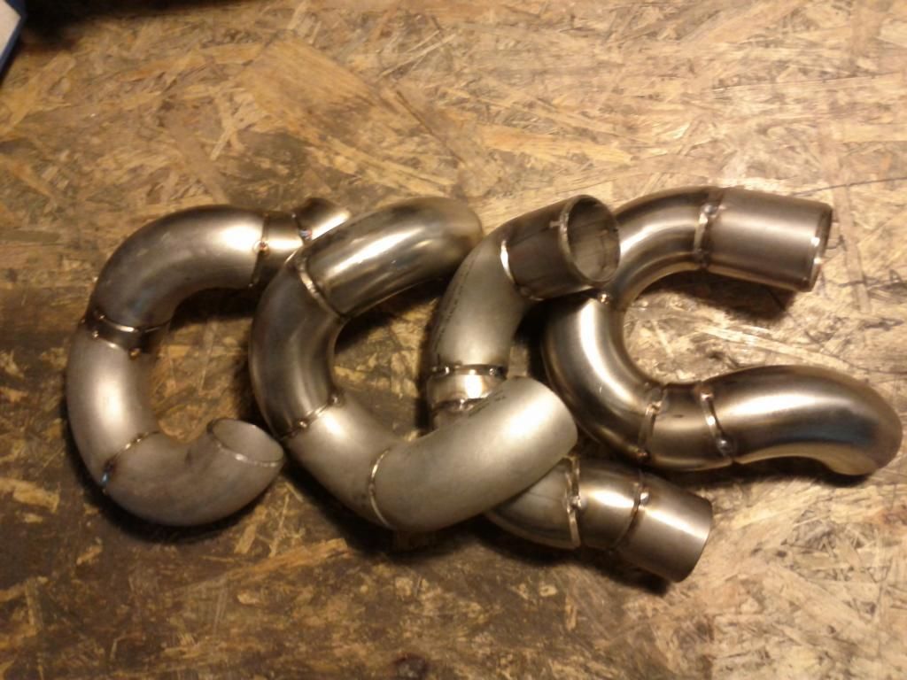

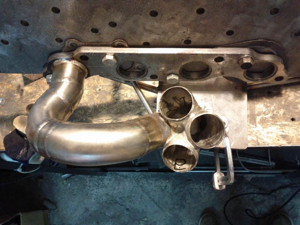

It will have plenty of access......anyway is a pain in the ass to do it due to the angle of the turbo:(
As you can see my calculations for equal length came out quite OK

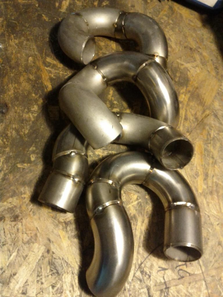

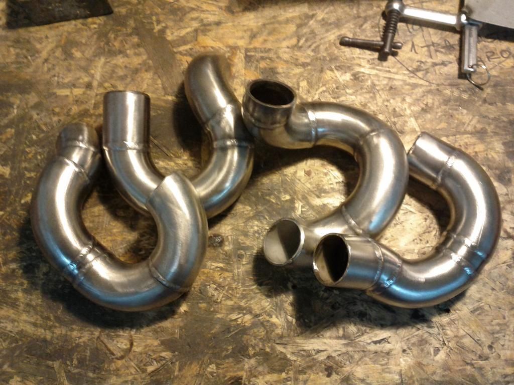

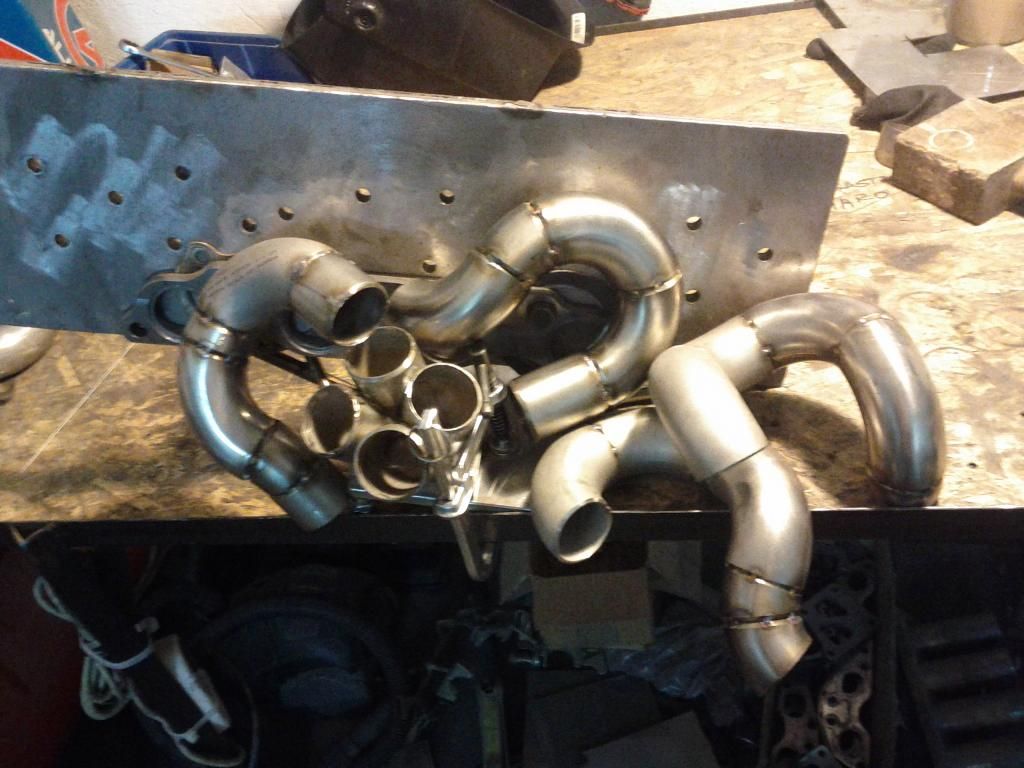

Allright chaps......
Now It's ready .....for final welding.
Sorry for not updating this in due time.....but I am busy working on my house and didn't had the the time to work on the manifold!
RO_SUNNY
Anyways......the 2'nd manifold will be different....because this one was a pain in the ass to make:))))))))))))))))))))))))))))))

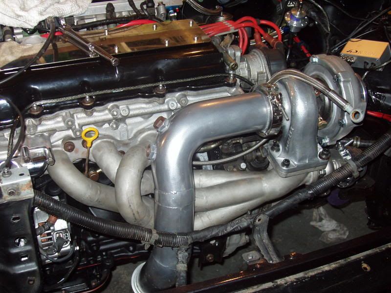

This one will be ready this week....but first I have to see if it fits and what mods are neede in order to accomodate it in the engine bay! ...there's no waiting list as no one pay'd any advance....so basicly is .....the 1'st one to pay will be the happy owner!

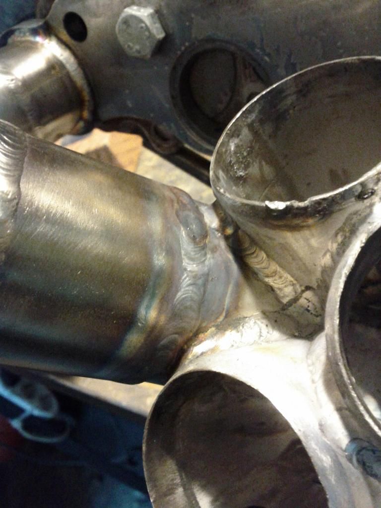

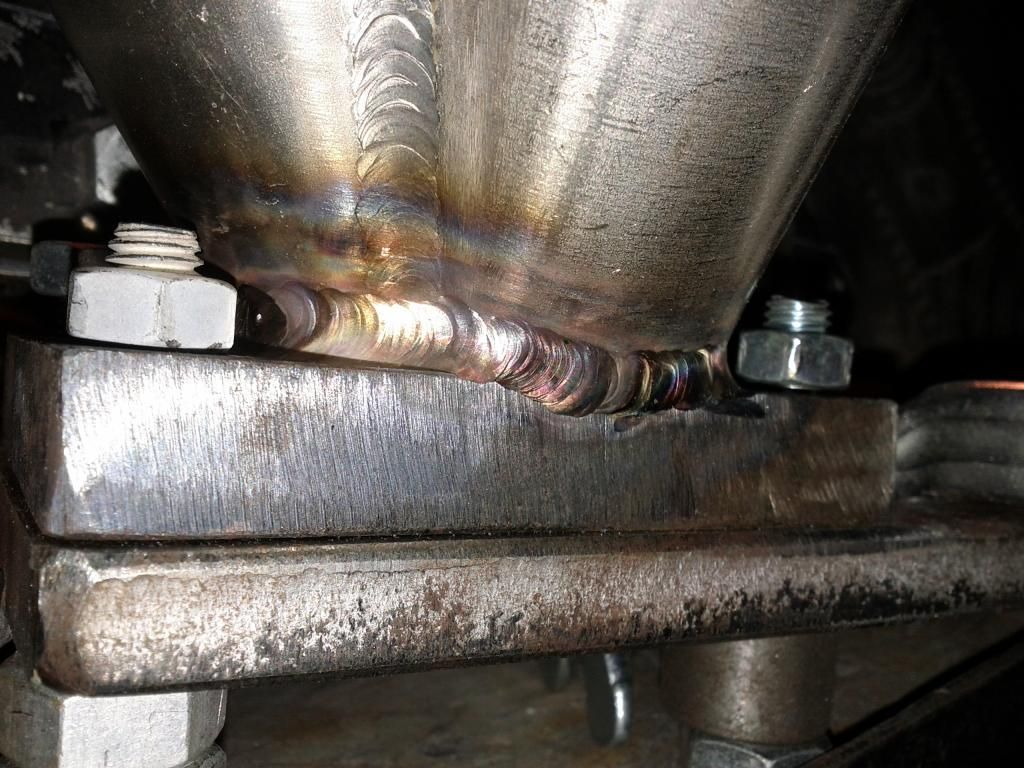

It does look heavy walled pipe.
Are you purging with gas when welding?

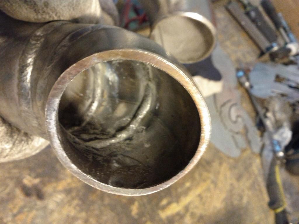

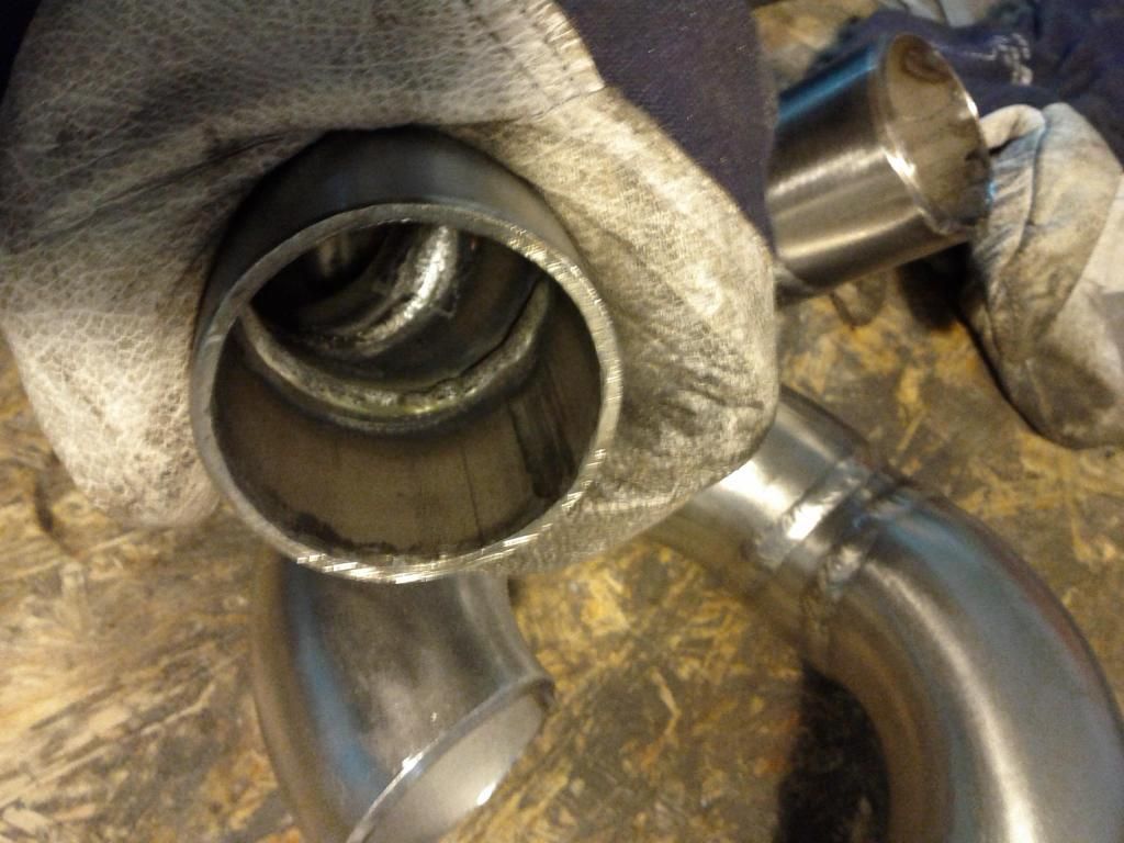

Hi Stu,

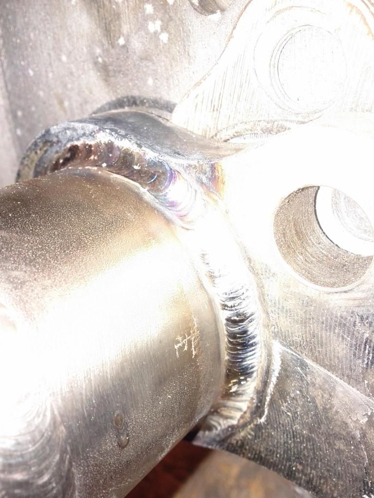

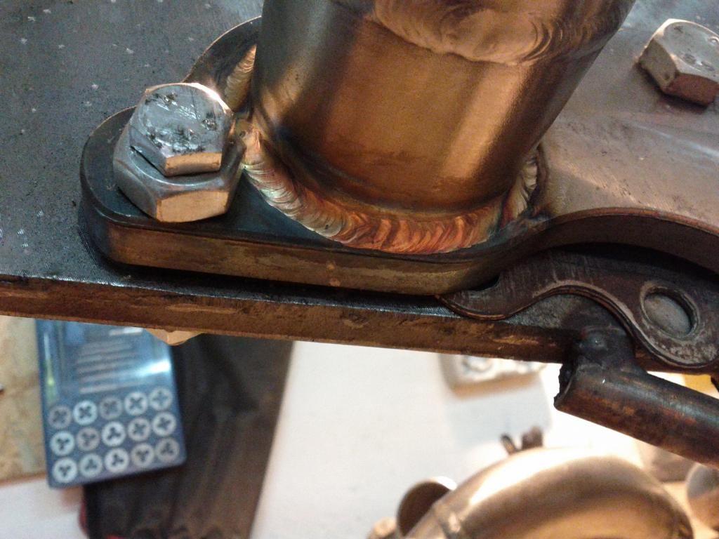

It is indeed, it's an 48 mm in diameter with an 3 mm wall pipes/elbows (Sch 10).
Yes all my work is 100%back purged to insure 100% penetration and 0 defects.
Check this photos out!
If it wasn't backpurged the root would have been black and ''crystalized''!
