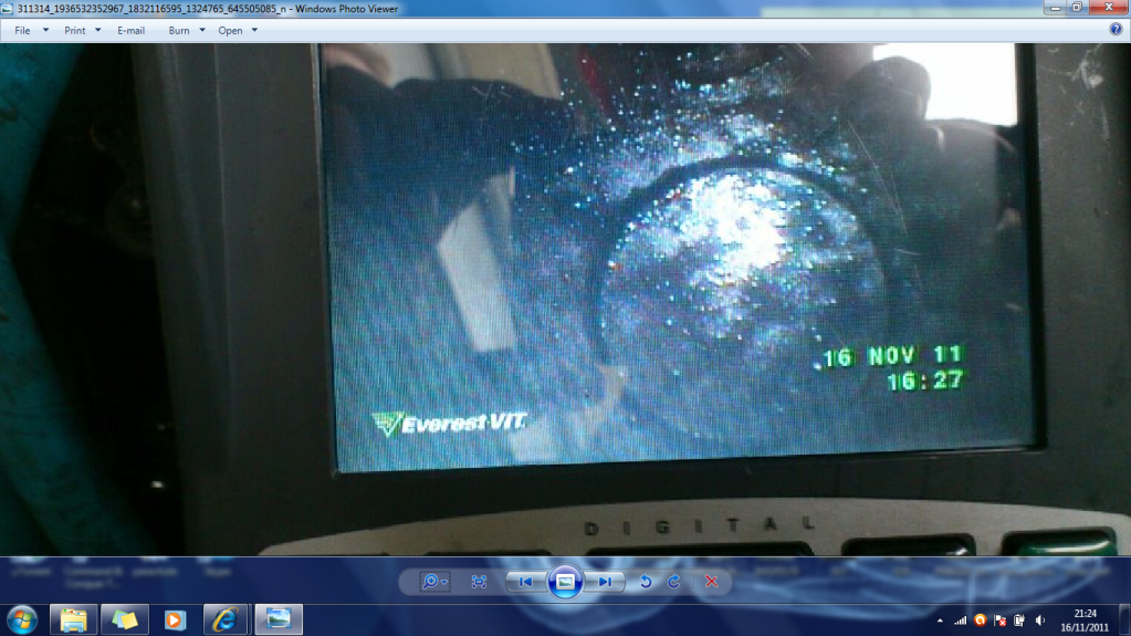

Over view (looking down from just in the spark plug hole)
Looking down on the Piston
You can see the oil sitting on the piston
This is looking up at the valves as you can see there is oil all over the place

Bores look good and it looks like the oil is coming from the top. Ill check my turbo tomorrow. but that doesn't account for the loss in compression

And looking at those bore scope piccy's you have had detonation and also melted the ringland..............did you fit a ecu and not set the timing/ check it on a dyno?
