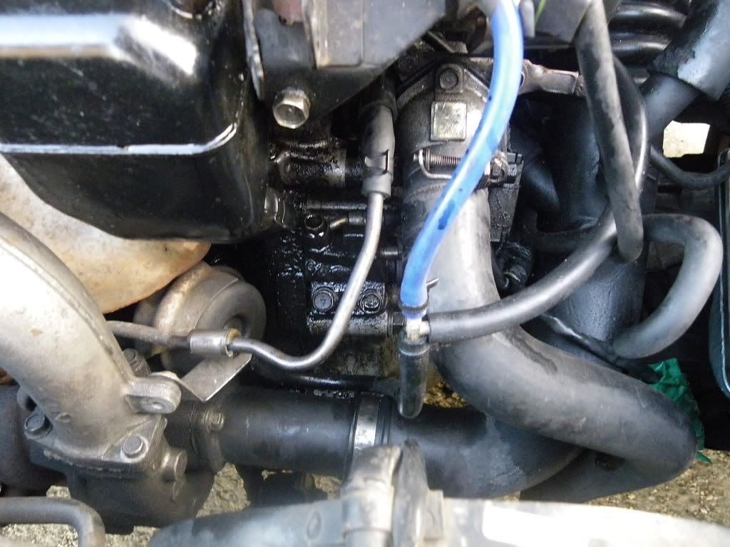

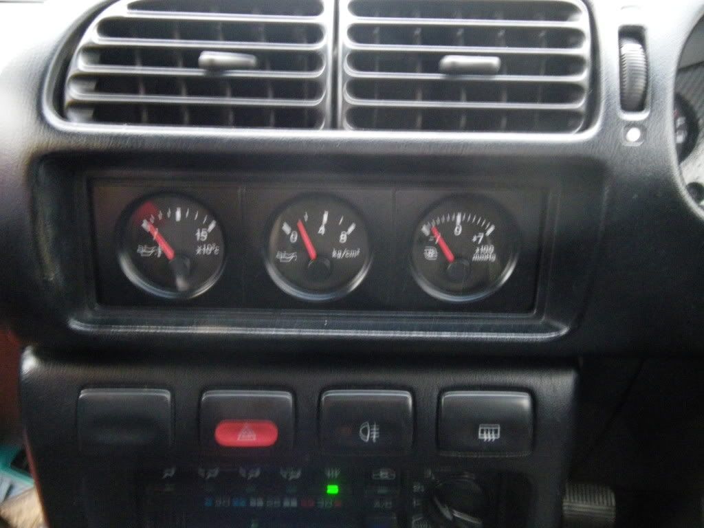

I have also got an oil leak in the front Left hand side of the engine just around the distributor... maybe not related and I think I may have (not sure) low oil pressure
the oil by dizzy will almost cerainly be the oil seal around distributor

Ok thanks bob I have another Dizzy with a good seal or Ill give a clean and put some vasaline on the one on ther now. do you reckon the car is ok to drive in the mean time?
providing there are no bigend knocks and oil pressure moves up when holding revs up it will be ok but dont go hooning it around untill youve sorted the prob or youll have a scrap worthless engine that you will be able to do nothing with
