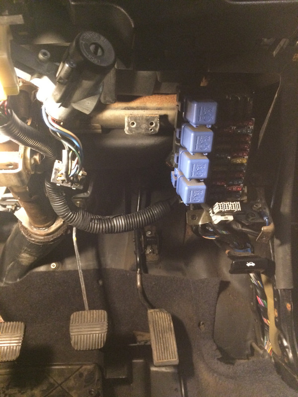

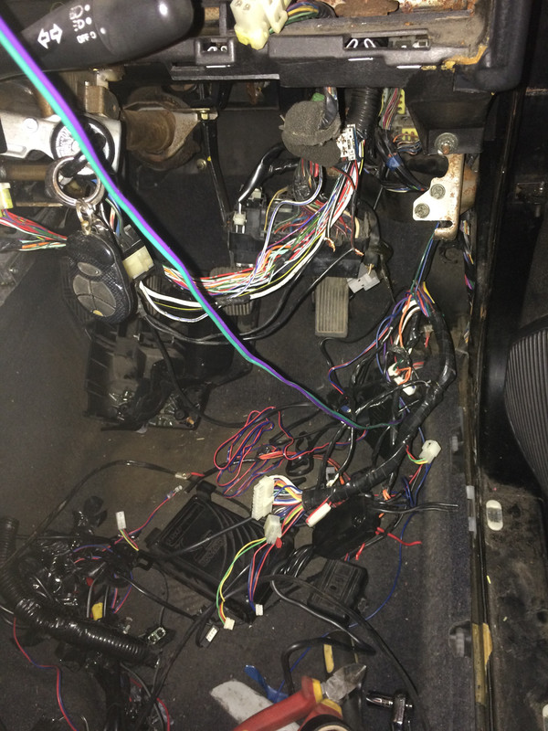

Sorted out the rats nest of wiring on my R from old sound system and alarm / immobiliser installs:
And got it running again with no engine light after cleaning up the ecu water temp sensor plug.
