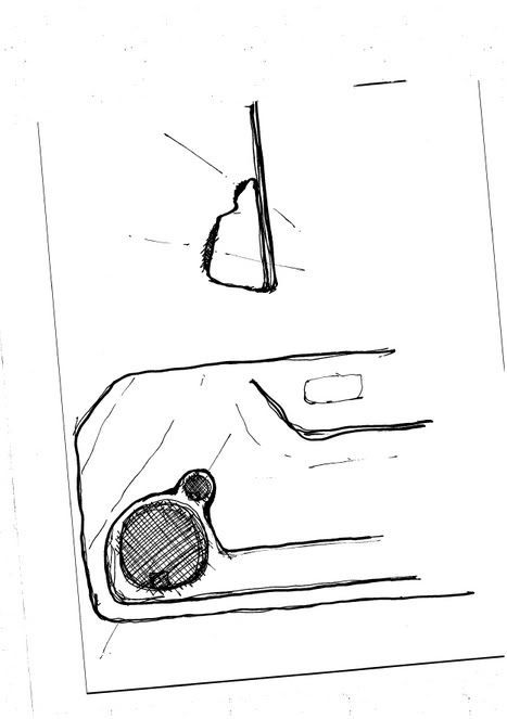

Thunder God said:
Toby your a real GTIROC asset mate, Keep up the good work fella.
Have you thought about building tweeter pods in to the top of your pillar mounts ?.
Cheers mate.
Yeah I have considered it, but reckon it would sound a bit harsh pointing right at your head. Would look nice though. Am doing these for a fella though, tweeter as part of the door pod:

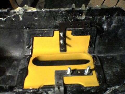

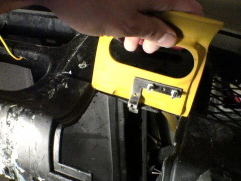

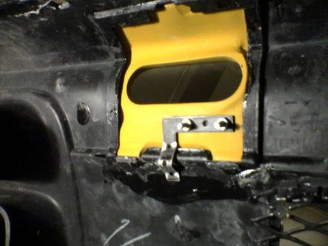

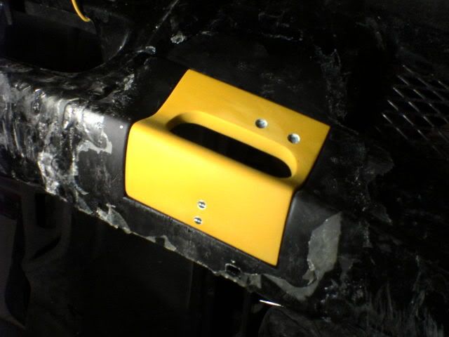

Here some pics of the fixing I've come up with.
You won't have to drill any holes in your bumper, think that would be grief to do and makes a mess of the bumper anyway.
So, the top bracket i've formed into a hinge, you drop it in and swing it down and it clamps in nicely.
The bottom one then bolts in and clamps down to the bumper.
This one is for matt-sab (yellow primer), he's gonna check fit on his when he gets it asap.
I'm just making my way through the thread in order of post/pm's.
Bolts will be cut down, they're shown a bit long, and the ones for the top clamp I've capped off in fg and smoothed over so you don't see the heads.
Any suggestions, tips on the fixings welcome, been a headache working out something which is strong and don't involve butchering the bumper.
