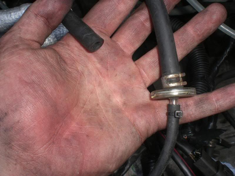

the pcv valve and associated pipework are a well known black spot for vacuum leaks, an easy way to check if your PCV valve is playing up is, when engine is warm i.e. after a drive for longer than 10 mins or so, leave engine idling and pinch together the pipe that leaves the PCV valve (item 1 in the pic above), if your idle speed drops/decreases then theres a very good chance the PCV valve is gunked up and can't close properly so it's in need of a clean or it just plain nakerd and needs chucking out.

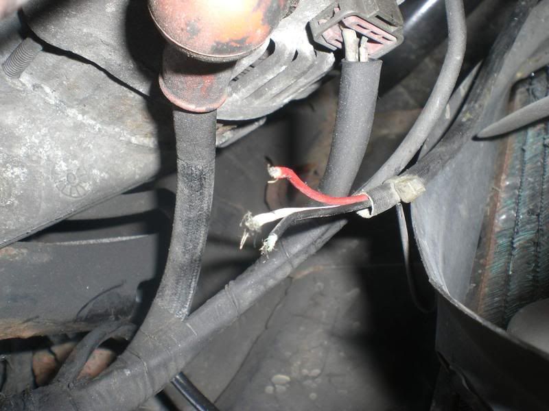

I need help , Loom connectors/Vac pipes! where?!
Putting car back together after doing some work, and like a dick I've forgot to lable some connectors up :roll: Can you kind people help me and tell me where they go PLEASE :-D

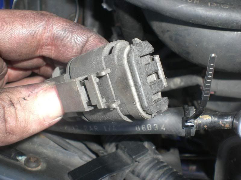

Connector number one

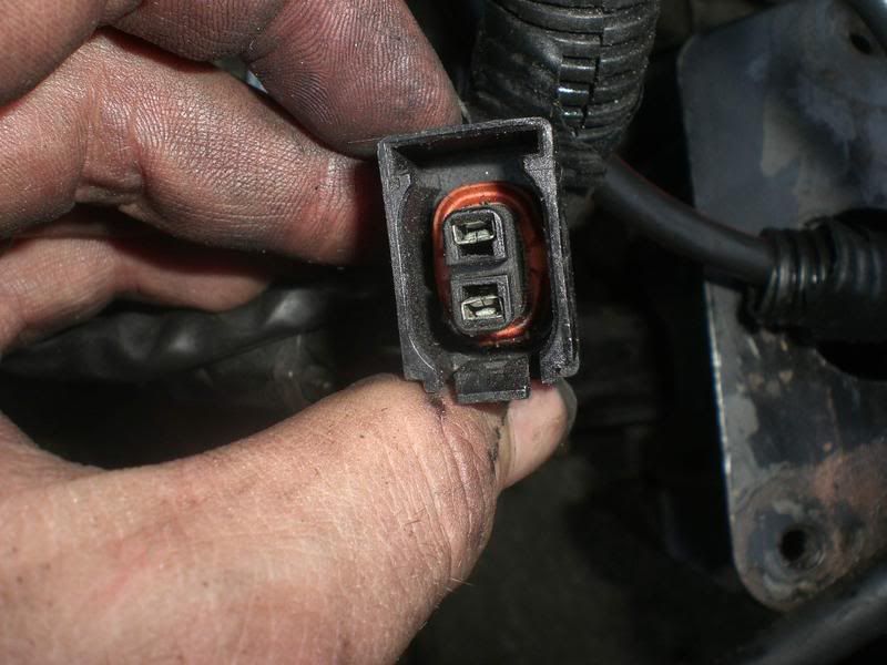

These two
Lamba wiring, I caught it and it ripped out the plug :doh: :doh:

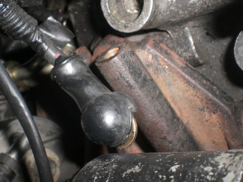

this earthing cable I think!

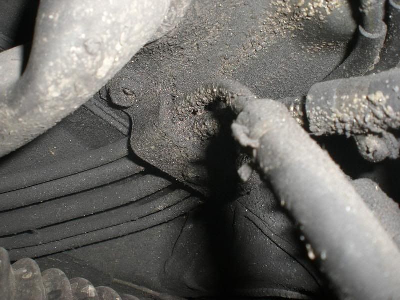

and last of all, I've taken the carbon canister out, but left with 3 pipes! one going to the bulkhead area, is thie the fuel vent? On the far left of these lost
and two from behind the inlet, can i just block these off?
Thanks everyone, I need my car running LOL :yuck:
gtir_pimp
where abouts is the plug in pic number one from? looks a bit like the one on top of the petrol tank next to that silver plate?
geoff pine

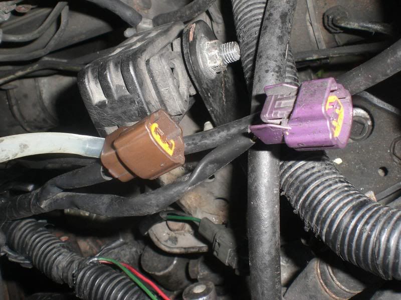

Picture 5 looks like the feed to the starter motor. Is the first one the connector for the boost solenoid?
