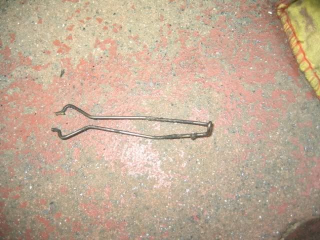

I've just taken my gearbox off my engine, r.e my other thread about gear selection. The release bearing was on properly, but at the bottom of the casising I had this just sitting there
It looks like some sort of retaining clip to me, but I haven't got a clue how to fit it. Anyone know what it is and how to fit it?

That fits into the clutch fork it holds it onto the clutch fork pivot.

Ah, i've just noticed the 2 notches on the fork, just trying to figure out how to fit it now. I'm assuming this would cause the gear selecting problem I had...

I wouldn't guarantee it no, I'd still get the box checked over while its out.
The spring wire doesn't look in very good nick so I wouldn't reuse it myself, Buy a new one otherwise it will just keep popping off.

I never had a problem with the box before hand. I've bent it back to what should be it's original shape and see how it goes.

If you are not going to check the box Adam, I would at least get a new fork, bearing and clip... I was looking for an invoice that I have (somewhere) to give you the prices and p/n's but I can't lay my hands on it.:oops:

I agree, It's a lot of work to rip it all out again for the sake of maybe a £100 for a new bearing and clutch pivot arm.
