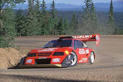

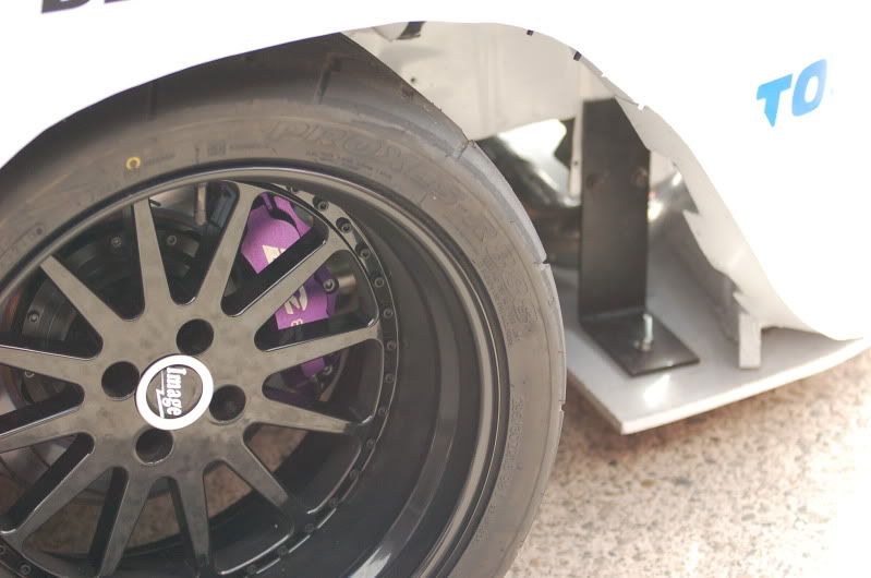

bracpan
Sturdy yes totaly agree,,,but does it work ? Doubt it very much plus its to dam heavy and to be honest quiet agricultural but a resonable effort...(im not going to start on the rear diffuser they did)
The best salon cars to look at are the DTM some amazing aerodynamics on them...but sadly I cant use on my car as the regs dont alow...Have to be a lot more subtle.
Another one ive been looking at is the new GTR..very nice undertray and spoiler. Or I will see if I can adapt one from another car....
Plenty of time over the winter.
One thought. If you do the undertray, will it be seperate? As it could be a pain to have to remove the whole front spoiler each time you wanted to work under the front of the engine.
dencon
What we need is something very light, projecting forward no more than 75mm, downword no more than 30mm. with small undertray, backword no further than inner edge of rad, all bolted to underside of bumper with couple of light stays, easy to replace as its likely to be damaged quite often on my car at least. I have a spare bumper off my new build free to use for a few months if of any help. cheers den.
