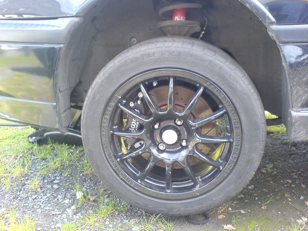

GAB may well be mythical in a few years as you can't get spares for them but here they are fitted:
