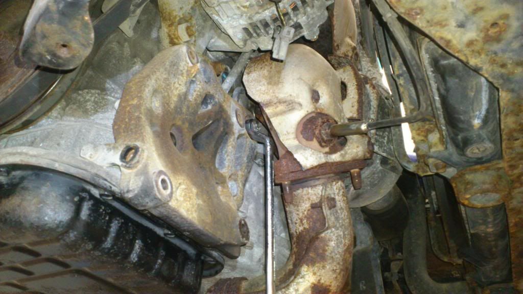

I have one bolt to remove and i've done this ... I even got the 825e belt on with very little effort!
I have a flexi head ratchet spanner, and STILL can't get enough on the bolt up behind the turbo elbow, my spanner fouls against the oil return pipe, and i think that's my problem! :( I need an grinder to shorten it a little!
I removed the radiator, etc to get to the compressor, i could not get it out any other way!

took the aircon out yesterday too about 1 and half hours. so easy with the rad out and def recommend and offset spanner like above made life so easy :)
