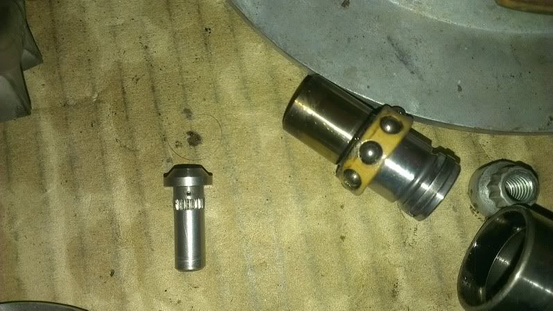

Look at the size of the hole in the restrictor in this picture. Thats how much oil flows into the turbo and the oil return is a 16mm pipe which is never going to be a restriction to that amount of oil.
The Doc

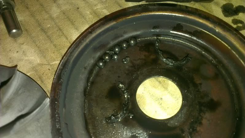

Mark please post the other picture of the failed bearing cage, you can clearly see the differance that heat has made between it and the cooler compressor side in the picture above.
Compressor side
There you go, nice little black pieces of brittle plastic from the exhaust side :lol:
And that piece of tim the remains are sitting on is supposed to be a heat shield between those bearings and the turbine running at 950degrees....laughable.
