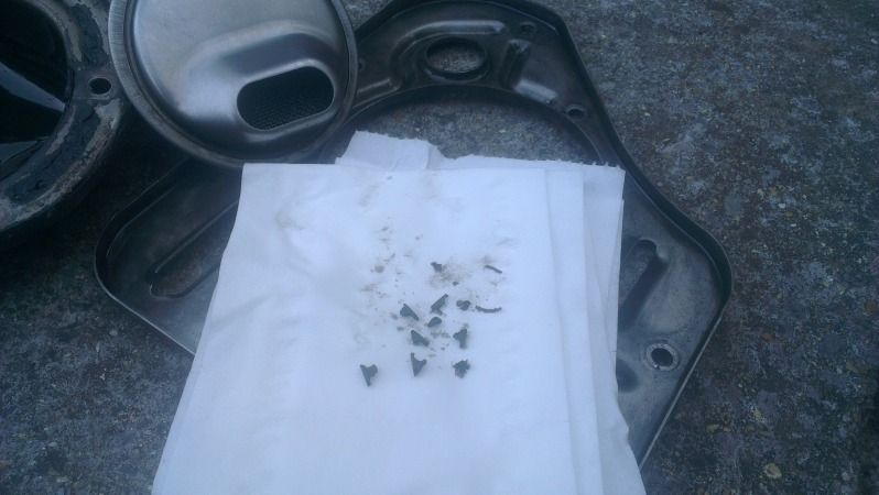

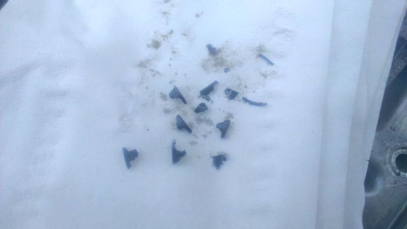

As my car is nearly ready to go again i thought i'd drain the oil and pull the sump pan and oil pickup off tonight, should have done it sooner really but the car has only been turned over by hand since the turbo went so any debris wasn't going anywhere.
The rest of the bearing cage :roll:
I'm pretty pissed off again now with what a piece of s**t these turbo's are for the money so although it'll probably be a pointless exercise i'm going to contact garrett and send them the pictures and see what they've got to say about it :evil:
