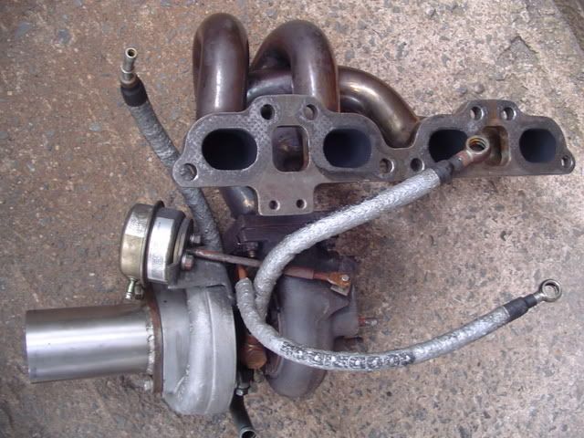

How direct were your water lines?i was just reading this http://www.turbobygarrett.com/turbobygarrett/oil_water_lines and the Garrett White Paper 1 - Water Cooling pdf and was wondering if maybe lengthy unrouted lines could be a contributor to this?
I was going to post that link as i bookmarked it the other night when i was reading about bearing failures. My water lines are both braided and follow pretty much the same routing (possibly better) than the standard lines. They're also covered in the expensive firesleeve wrc cars use .
Pics of them on my old T28
