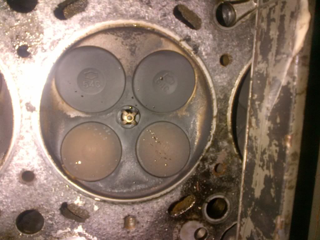

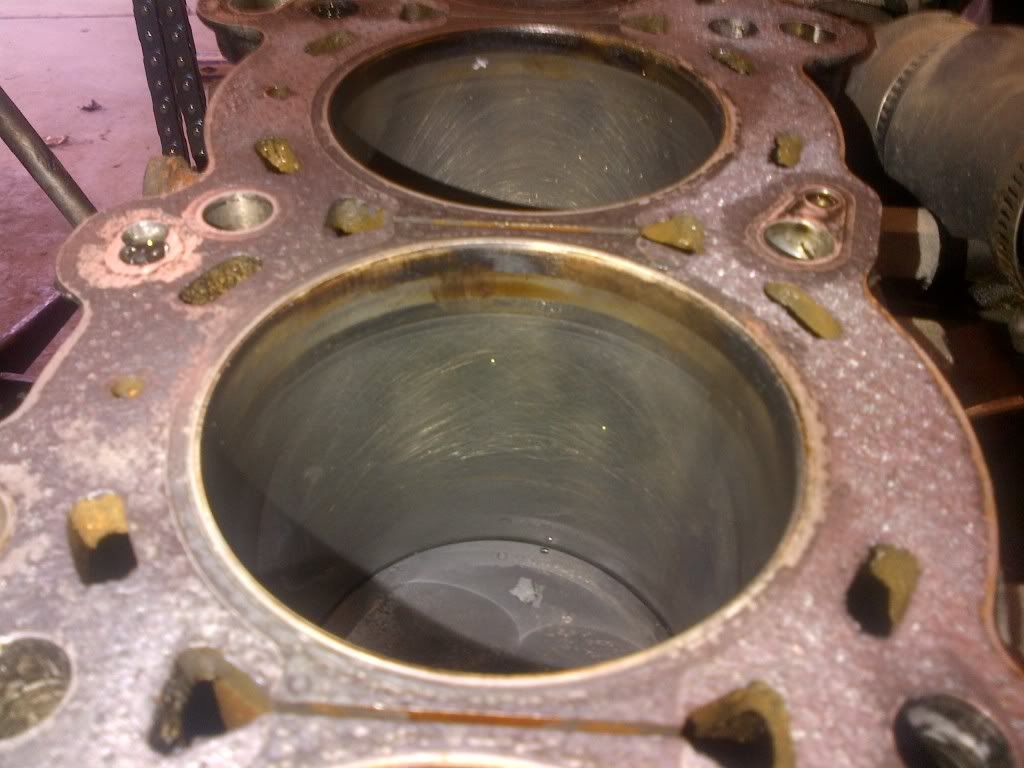

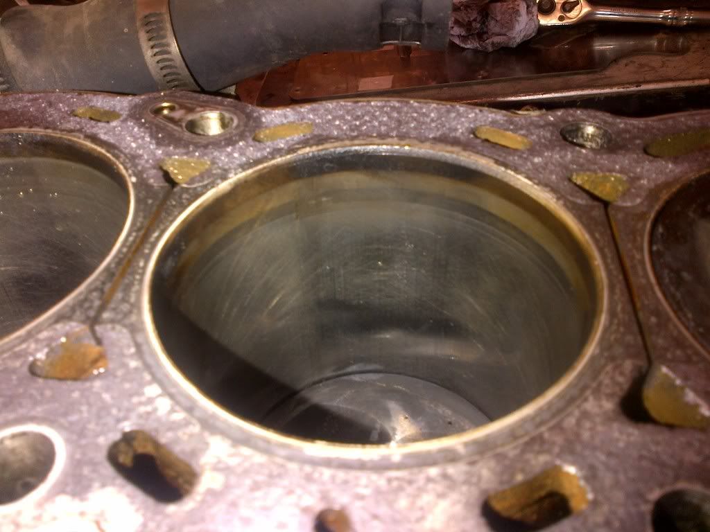

Anyway.... I got the head off today and what did I find- Nothing I was expecting. bores seem perfect with hardly any wear all round, valves seem fine. the only evidence of anything wrong is the brown ring below the top of the stroke see pics-
Is this Pre det?
#3cylinder head and valves.

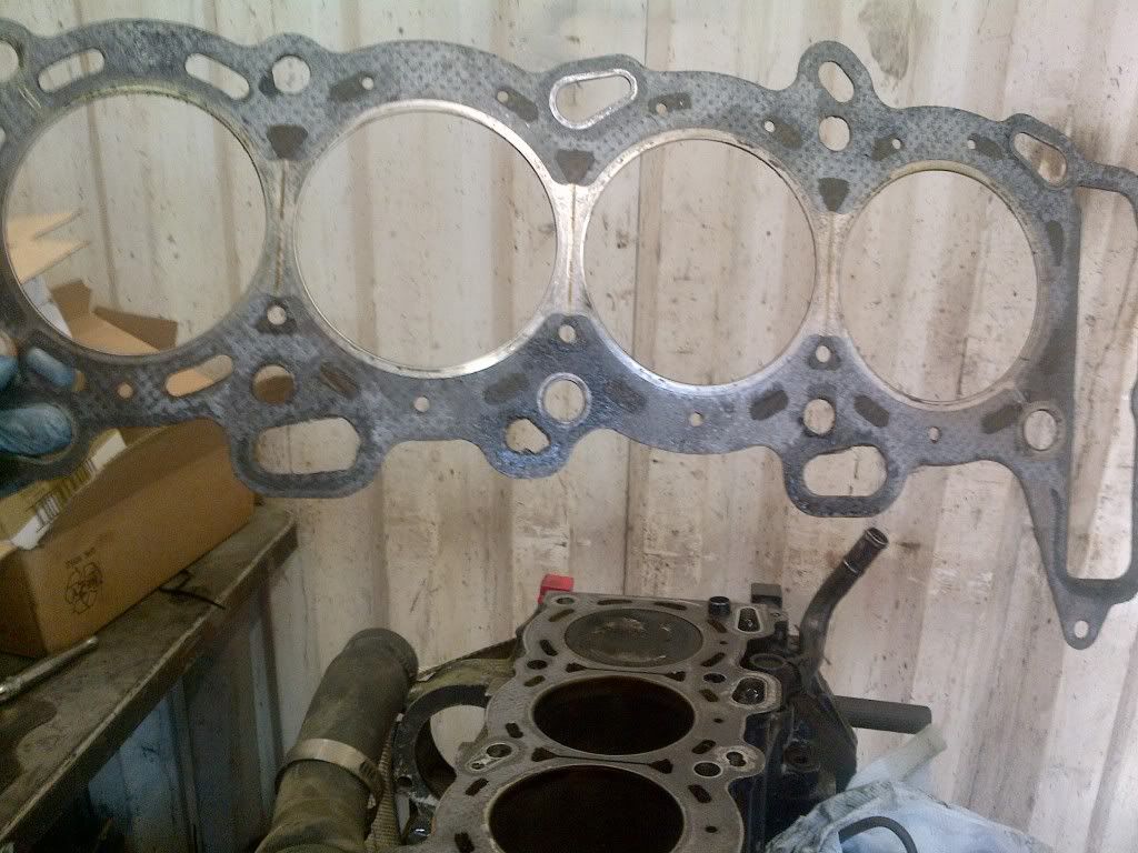

Gasket shows no signs of breakdown
this picture does show some gas leaking past the pistons but not that much
I was expecting to see much more gas passing the piston if the ringlands or the rings had gone

Bet it's the ringland there looks to be det marks on the head and the inlet valve side of the block
as above, i would be confident that ringland is cracked.
good news is that the cylinders not marked/scored but does look as though shes been detting

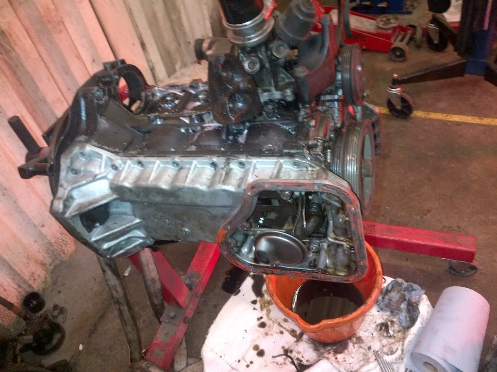

Failed! Ive just spent the best part of 3hours trying to get the sump off the block with no sucess. the manual says to use bolts from the gear box/sump mating faces but there are no bolts fitted in mine:doh:
other methods Ive tried is a block of wood with a big hammer and I can't fit a stanley blade between the faces
anyone know any other bolts that may fit these holes on the car as I cant find any for looking
or does anyone have any other methods or removing the sump?

Take that inspection plate off, the black painted one. There's 2 in there if I remember correctly.
Also I think you have to take the pickup filter off that's inside.
Its been a while since I did mine so I can't quite remember.
bensmith907
the black painted plate is infact shadow lol I got those two bolts.
So you reckon the pickup needs to come off too?
as stu said, make sure all the bolts are removed at front of engine around pickup pipe area
then use 2 bolts at back of ally sump to thread down into the block which will gently prise the sump pan free, dont force it or youll snap it and il have another sale lol

I dont have any bolts to run down the two holes- any ideas where else on the car they are used other than into the gearbox?
Ive used this manual to get to where I am now, so that should be every bolt required- (except the compressor gusset which I dont have a clue about where that is???)
http://www.gtirworkshopmanual.com/default.aspx?v=192
what ever you used to seal it on when you rebuilt this thing is amazing stuff.

and the Cosworth Gasket is my first choise too but I hear they take some modification to get them to fit. has anyone done this before?
vss irvine
its only enlarging the dowel holes slightly, nothing to worry about.
