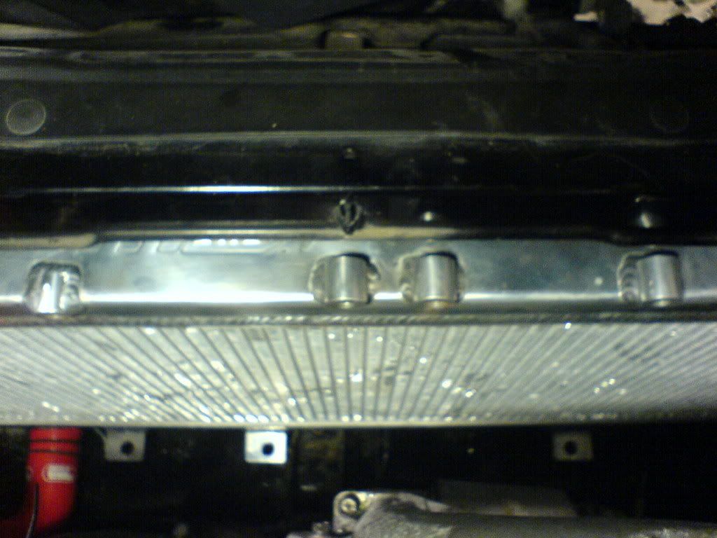

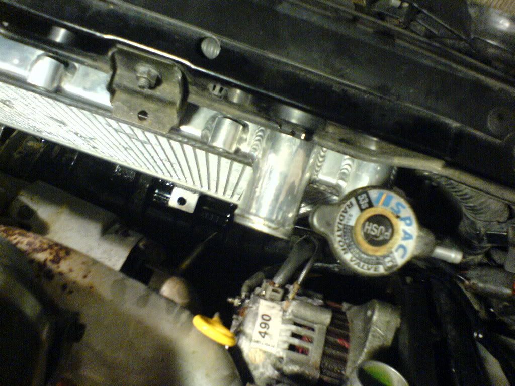

As Rob has mentioned. It will fit but you may (will) have to ditch o/s OE fan. There is plenty of room to fit the OE n/s fan though. The rad itself is a direct fit onto the OE mounts.
The all alloy rad may be overkill though on a road going gtir.
Here's a couple of pics to give you an idea... I have no AC fitted though.
