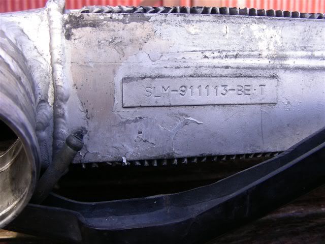

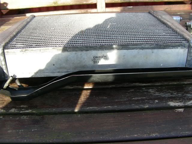

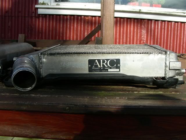

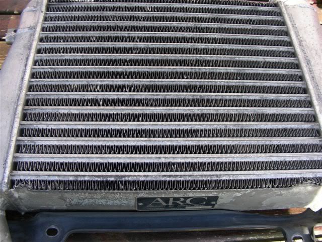

Having received the ARC TMIC I can now compare it with the OE TM.

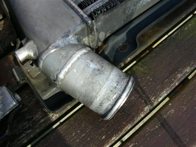

It's been through the wars, dented in a few places and the inlet / outlet pipes look like they were an added extra. I have flushed it through and pressure tested it and it hold air so I am happy with my purchase!

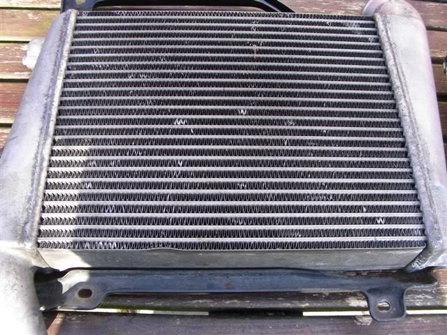

OE core thickness is 60mm... ARC is 68mm
OE has 24 chambers, ARC has 14 (but thicker) chambers.
Side tanks are the same.
OE chrome cover will fit with a minor adjustment.

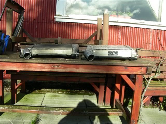

OE TMIC
ARC TMIC
Side by side
OE TMIC
ARC TMIC
ARC TMIC rear
ARC TMIC front pipe

Looks good.
TBH i think the majority if not all are a little rough around the edges due to their age, but as long as they hold pressure and have no negative results all is good to go imo.
It does seem however that these items were very changeable in design as mine doesn't have the welded type inlet / outlet pipes, looks exactly like the OE apart from the core of course.
I also found that the inlet / outlet pipes were slightly larger to, slightly :lol:
My OE cover fits on, a little stretch and you will have it on :lol: Looks good though and will be a nice addition imo.
