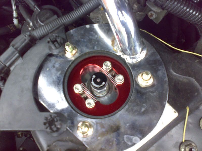

Kev@Apex said:
I dont know anybody who has tried fitting EDFC motors to Apex coilovers, so dont know if its possible.
Pics recieved - thanks.
I have just tried.
The rear EDFC motor fits the Apexs so you would need 2 new motors at least.
The main problem is the adjuster on the bottom of the motor is about 1" too short to reach inside the Apexs to actually adjust anything. It's the right size hex head, just too short. If the Apexs adjuster could be removed and something longer could be fitted that the Tein can reach, it would work. (I don't know if it will simply unscrew with enough effort. I didn't fancy trying and breaking something)
However, then there is a loss of range of movement issue. The Apex appears to be 10 clicks per turn, 3 turns in total. The Teins are 8 click per turn, 2 turns in total. I couldn't work out how to get my EDFC into 32 point adjustment to see if it made any difference. I personally could live with this loss.
