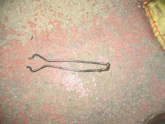

Adam L said:
I've just taken my gearbox off my engine, r.e my other thread about gear selection. The release bearing was on properly, but at the bottom of the casising I had this just sitting there
It looks like some sort of retaining clip to me, but I haven't got a clue how to fit it. Anyone know what it is and how to fit it?
lol erm yeah my clutch is not working and i cant see this retaining clip on my clutch fork either when i pull the gaiter off, looks like i will have to get my gearbox off to fix it, anyone know any pulsar friendly garages around Hertford?
