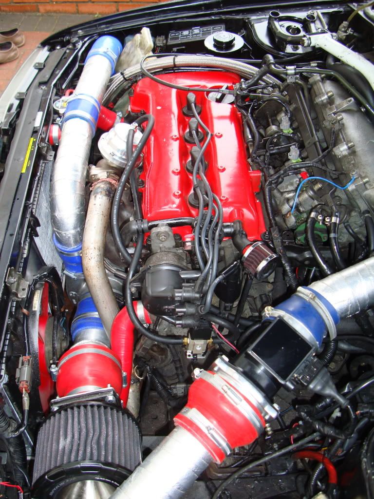

mine same as above, 76mm, 2x45 steel pipe, z32 + large itg foam cone stuffed up against wing wall (about 1/4 of it blocked as no room) made 350 @ 1 bar no problem. itg sucks though as is oiled and buggers the maf up every so many miles. am now on a dry simota cone/funnel. but am going the k+n route.
my setup picture, excuse ghetto cardboard lol

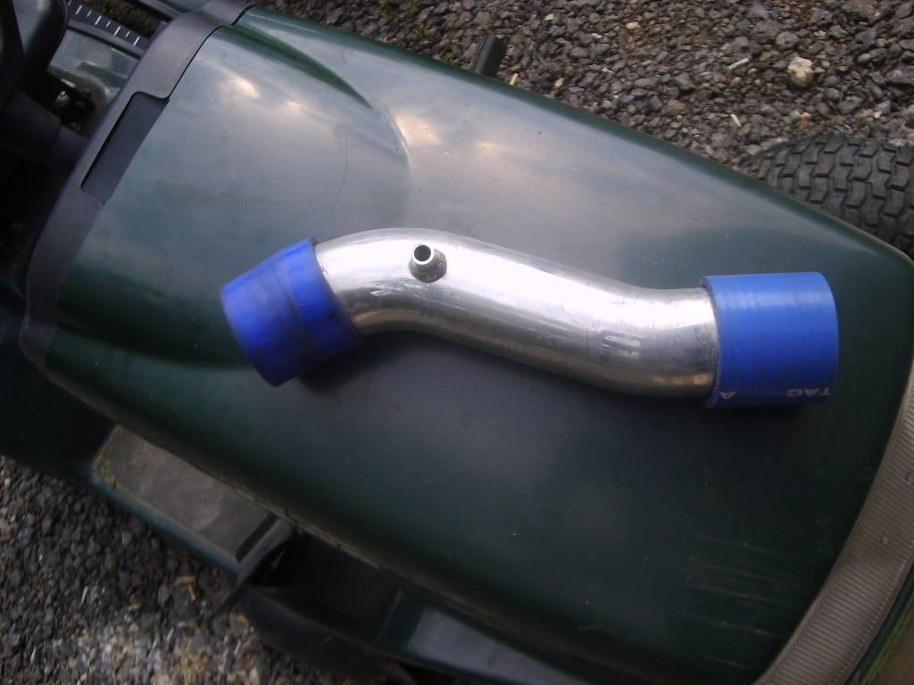

bought of ebay no metal work involved, I would not expect anyone to be able to do metal work, but if you are modding your car why fit something as restrictive as a standard part, 2x 90 degree bends have a very narrow relative cross sectional area.and every restriction you put in pre turbo is multiply's post turbo.
Thats a nice pipe, not seen them like that on ebay before or I'd have got one myself.I was just trying to keep it simple as others will search and find this thread.I thought you might have made something like that up yourself and maybe welded 2x45's together or something but thats a good solution.

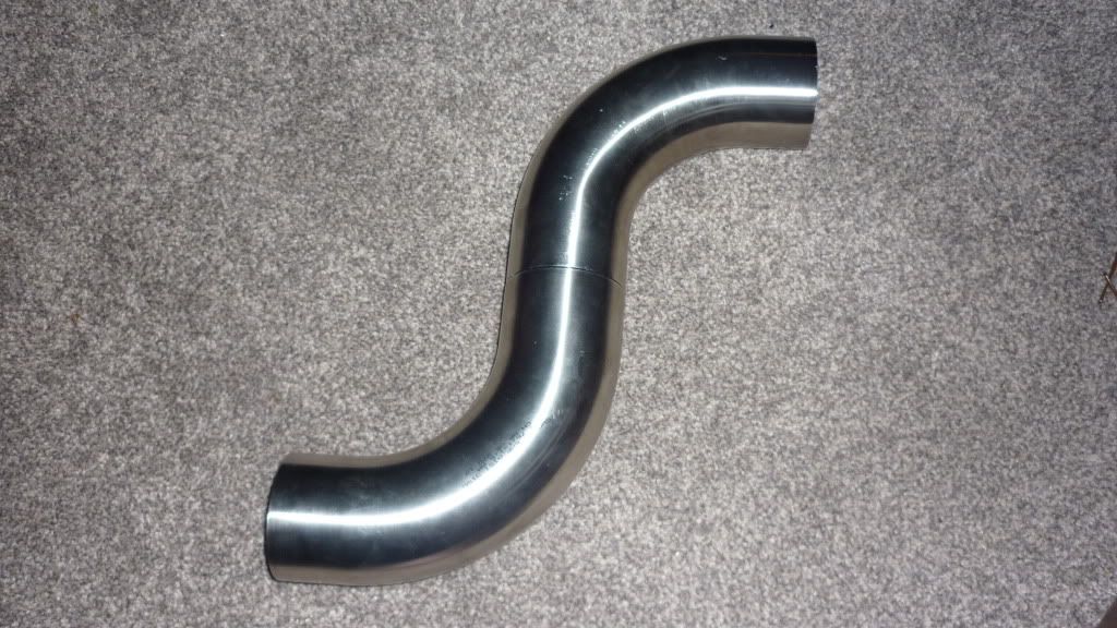

These are the two 76mm x 90deg stainless 316L bends i have

£70 was cheap for the alloy pipe with the 2 quality silicons (not cheap shite), do the 90 degree thing and strangle the turbo all the stuff i write up is just for fun people..lol
