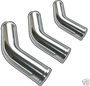

so should i change the 45deg pipe to 2x90deg pipe's or is what your all talking about only apply to the standard maf?
Danny i thought that inlet pipe you had was a 45deg with the filter on the end
Its 2 x45degree swan neck on my old set up (new is blow thru maf and 800rpm idle) and i had to have 950rpm idle with that, it was the best compromise for power (less restriction and shortest lenth for flow) and drivability whilst keeping the maf as close as possible to the turbo
on the picture above there is no z32 fitted, sascha uses a blow thru mounted buy his intercooler (which is'nt a z32 either),
if you use a z32 on a single 45 degree bend you will get turbulent airflow and it gets worse the bigger the compressor is on your turbo, as you will find out on the md196. 71mm compressors are bad enough (2871/3071), you can fudge it when mapping but it is'n clever (if done to a power f/c the car will start to hunt at idle)
You need a minimum of 2 x 45degree bends on the compressor inlet to the maf on a draw thru set up (made of alloy or steel as silicon collapses under vacuem and robs you of power)
johnsy
so it'll be fine with 2x 90's then in stainless steel, or does it have to be 45deg bends?
i was about to send the 90's back
if i remember rightly my old silicone setup was 2 x90 and it avoided the bottom rad hose unlike the 45
Mine uses 2x76mm 90 degree bends, no problems with the Z32 and also gives you more flexibility with positioning the filter than 45's would.Using 2 45's will mean the piperun will have to be longer and you might run out of space up against the n/s wing with a big filter.
