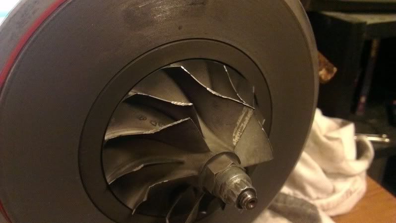

I took my turbo off just now and started stripping it down, its got a bent shaft and both the turbine and compressor wheels have touched the housings so its basically a big lump of scrap :evil:
Compressor damage

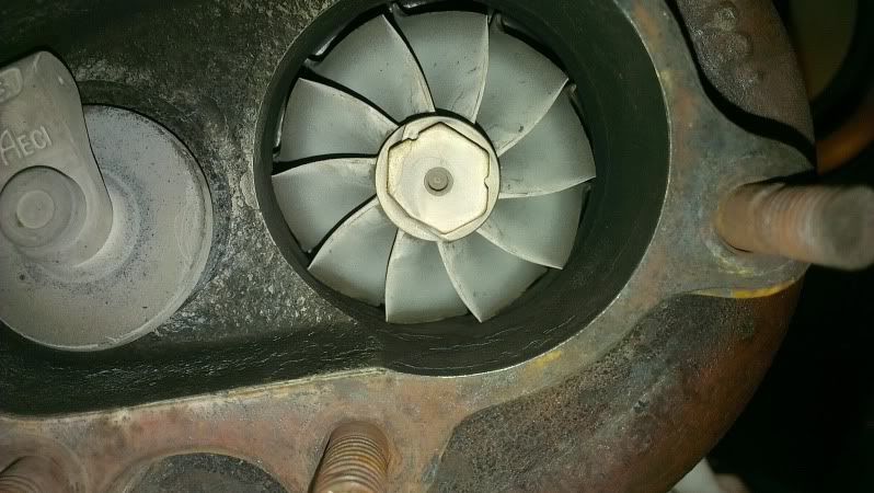

Notice the big gap at the top of turbine wheel in this picture

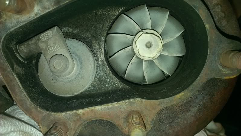

Spin it 180 degrees and now the gap is at the bottom :doh:
