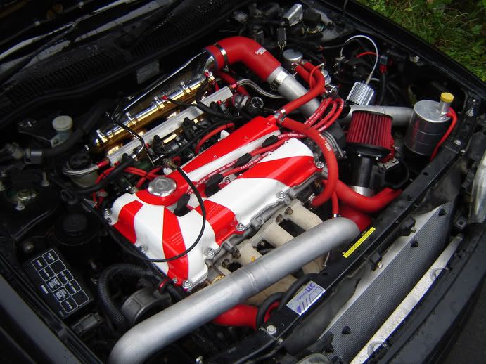

Paint stripped it all power washed it all with water to get all the shit out then wet sanded it all with p600 used all glasurit products on it, 283-150 etch, 285-31 wet on wet primer, 55- line basecoat only just started using 90 line over here been using 90- line for 9 years in uk (90- water based paint 55- solvent based) and 923-144 racing clear 2-1 with 929-91 fast hardner with 10% 352-91 reducer glasurit clear is the best clear ive used and 109 clear is awesome clear has a wicked shine on it but takes alot longer to dry used with 30% 352-91 unless you have a infra red lamp to heat and dry or other heat source of 60+degrees, cost using those products will not be very cost effective for a rocker cover as you could paint 10+ rocker covers by buying the smallest possible amount from glasurit and its not cheap being one of the best or the best paint manufacturer in the world. use to spend $50000 a month on paint in my last job painting 8-10 full resprays a day.Welling_AL said:What product did you use to get that finish ??
Did you key the surface first with wet n dry ?
Any advise for a home jobbie much appreciated !

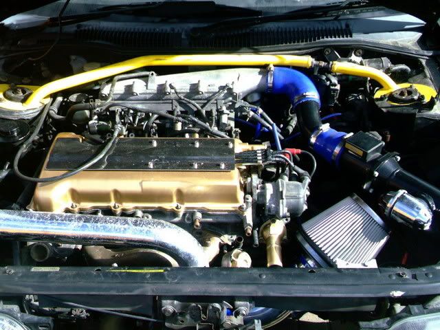

Nice blow through set up as well, did you set that up your self if so wha differences did you notice over the original set up ?Dan_GTiR said:I have a nice gold rocker cover, that I painted myself.
that looks very shinybopper said:ive gone for the blue, Steve i like the look of the bolt kit i noticed you did them in blue but how does the blue come up, do you think it will go with my colour.
