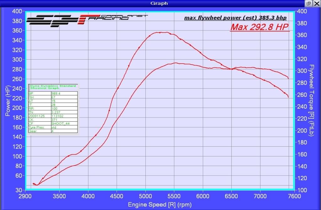

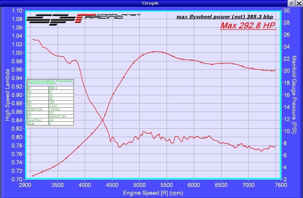

I had my own car mapped today, spec includes 2.1 forged engine with ported head and hks 264cams, brand new gt3071r and standard actuator, 3" elbow but the rest of the system is 2.5", z32, 650cc injectors and power fc pro. Did intend to go to 1.8 bar but they backed it down to around 1.5 and told me i need to change the exhaust to get over 400bhp?
