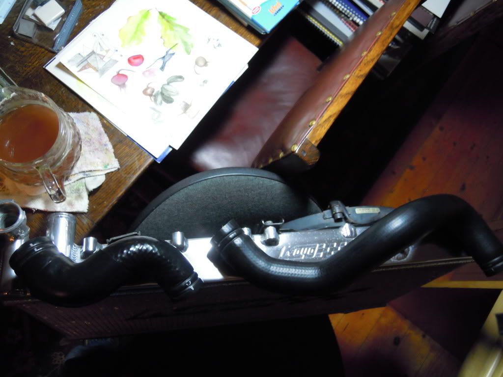

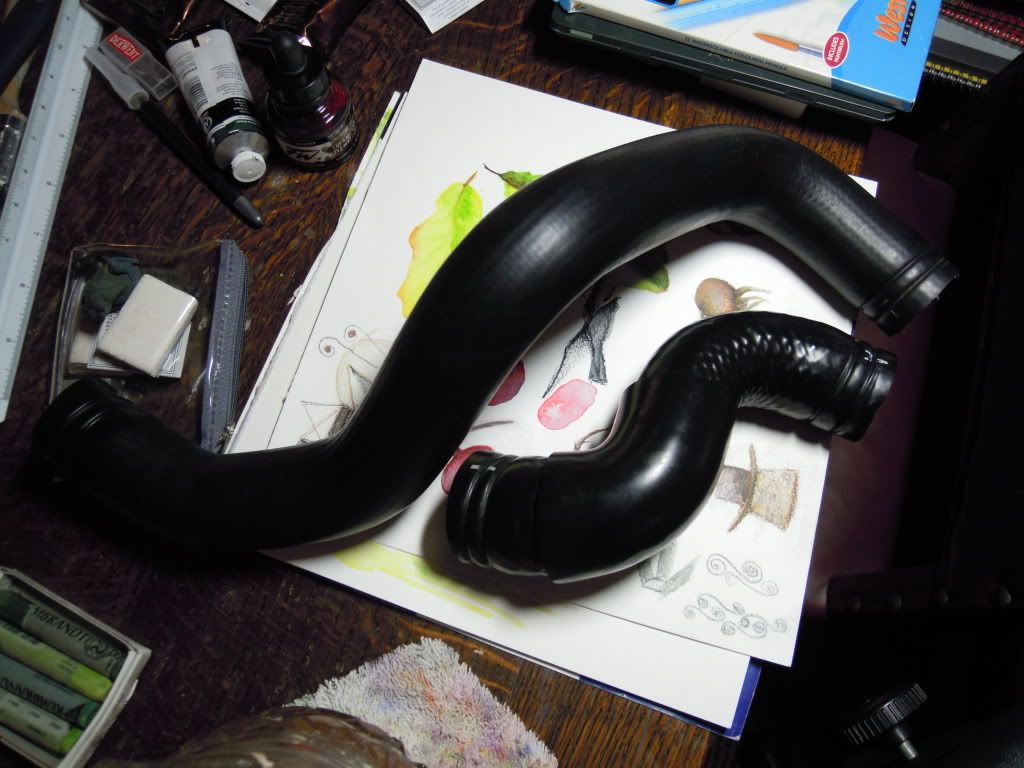

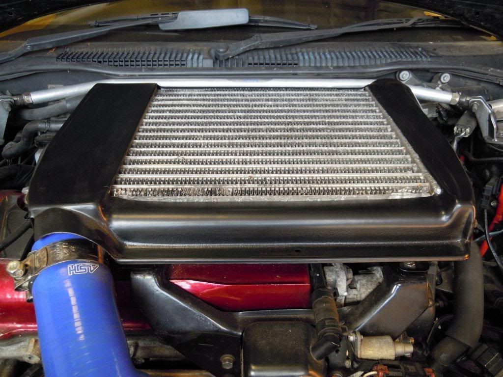

On the black theme.... decided to revamp my OE rad hoses. Think the black agains the alloy rad looks quite fitting.

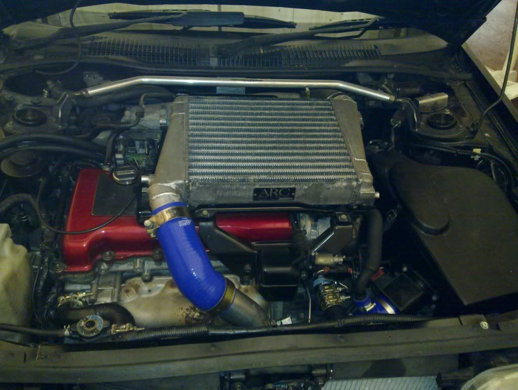

Having fitted Z32 and Blitz 660 injectors, I got things plumbed in enough to start the car.
Changed parameters on EMU to reflect larger injectors and MAF and started the car.
Car started fine and ran ok... AFR 11 on idle and 13-14 at 3K rpm. Obviously, it need mapped and I do not want to rev it un-loaded.
One thing I did notice was noisy injectors... tappet sounding but resinating from fuel rail / injectors.
Do you think this is normal?
I want to build the rest of the car and get it mapped soon.
Cheers!
Me evo 560`s ticked their brains in, but turned down the latency on the nistune board and the tickyness died right away and afrs are minted on tick over now :)
Braveheart
Thanks for the feedback!
When I changed the injectors I looked up the lag for Denso 660 and reconfigured e-manage for that (0.74ms) Maybe it's perfectly normal noise at tickover or it will improve when set-up properly.
I've left it as is and cracked on.

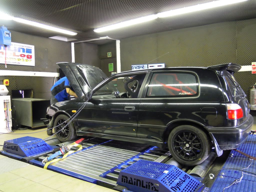

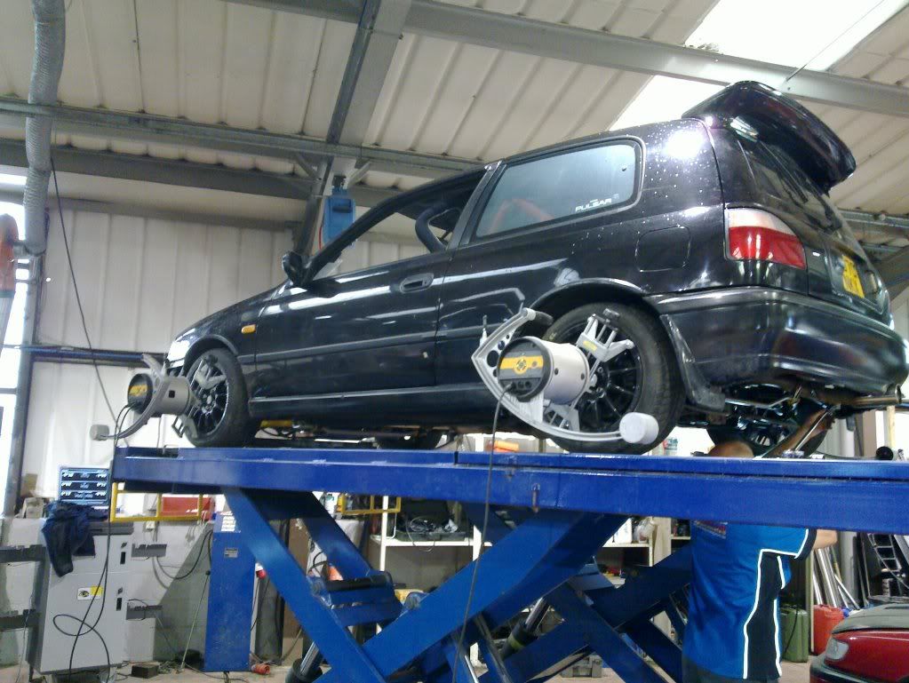

Car geometery was setup and car was mapped at a conservative 350bhp.
I am now working on body work. Need to build front end up, paint bumper and off side wing and fit replacement off side door.
I may leave door and wing until after track session at knockhill on the 13th Nov.
Pics to follow!
Braveheart
I was charged 76.60 quid per hour on the dyno... 50 quid suspension setup per hour.... vat's not included.
A lot of overheads and outlay on the equipment.
Obviously, the more you want the longer it will take. If I wanted to squeeze every ounce power out the car it would take longer and cost.
We never even touched on the science as it made my required bhp without but I shall return. ;-)

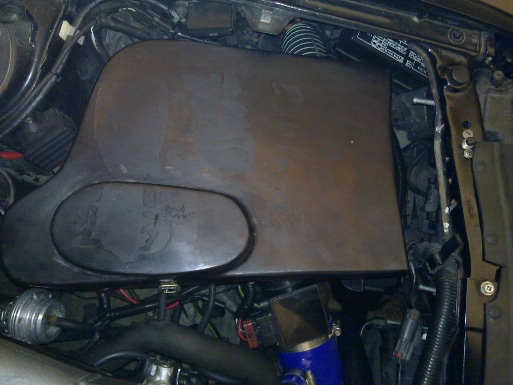

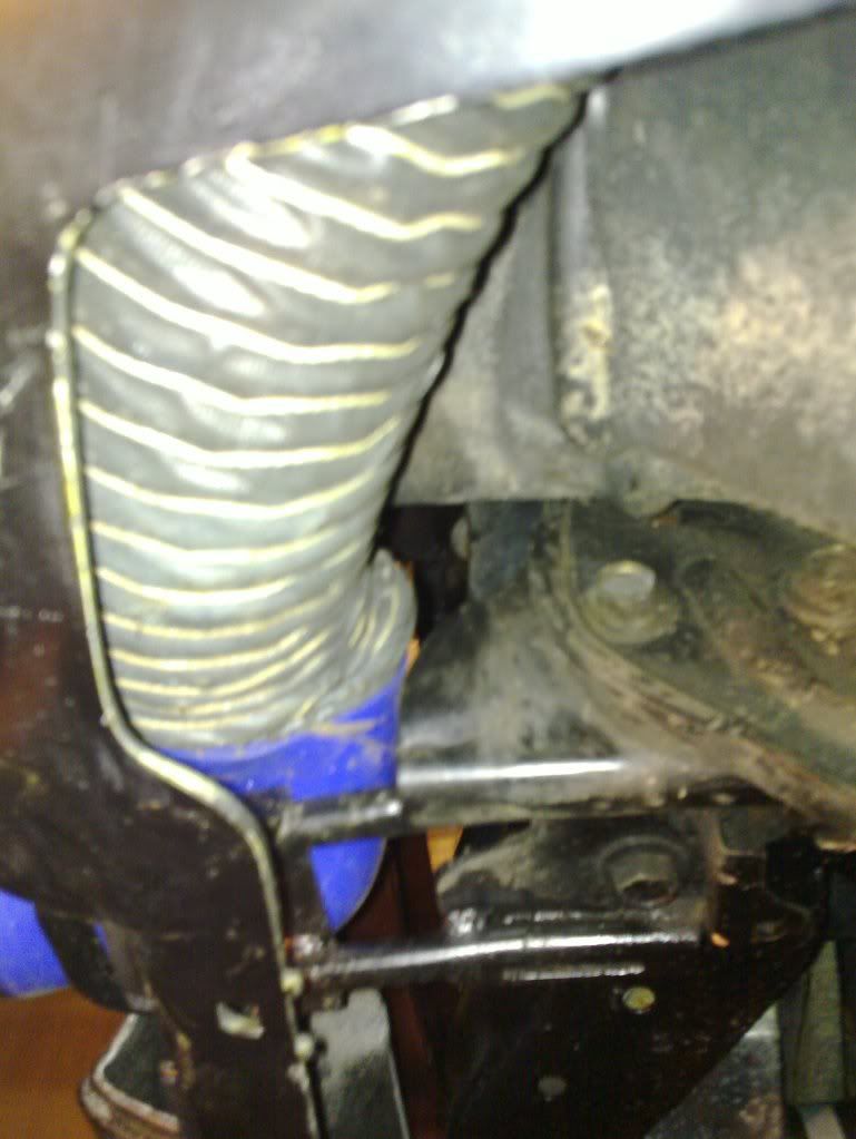

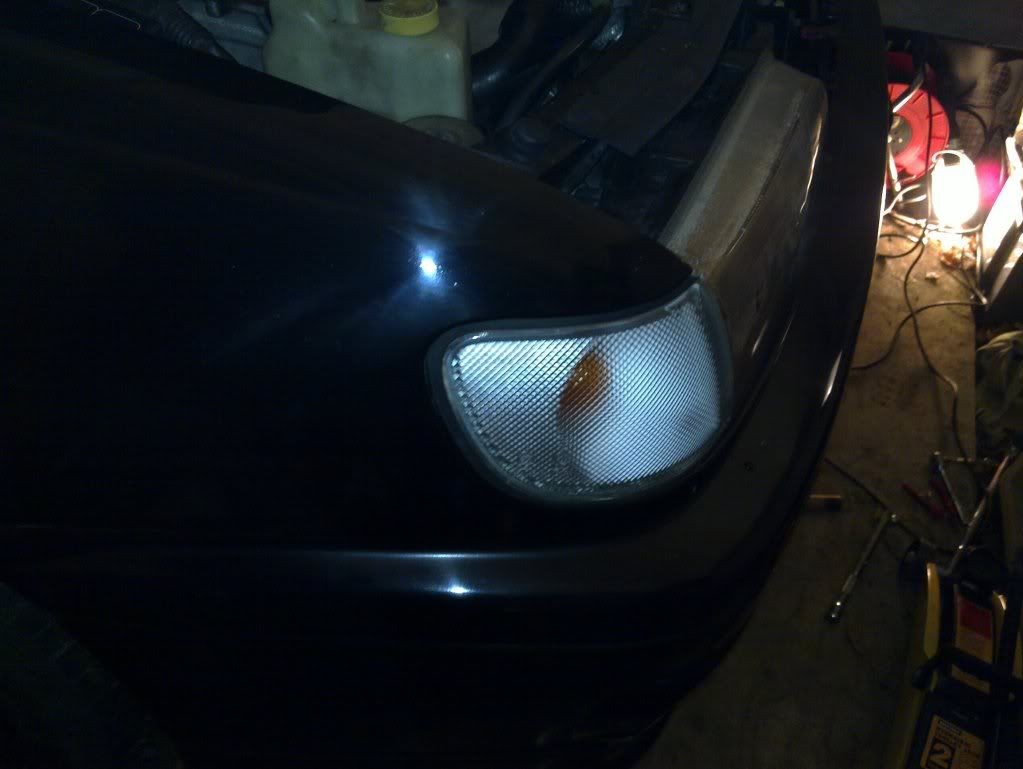

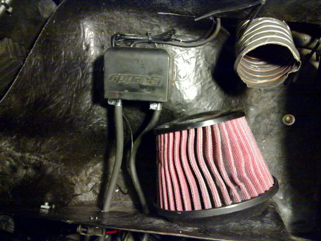

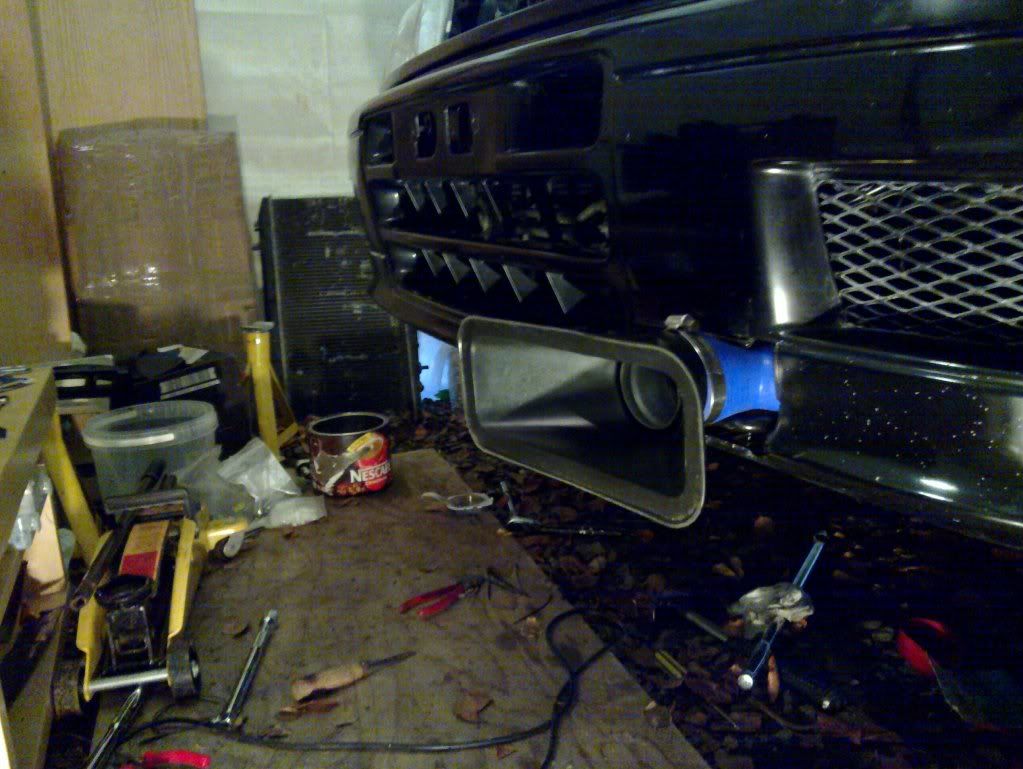

Fitted my newly painted wing and bumper and temporary cold air intake.
I want to keep my brake ducts but will have to rejig the air intake. It's a bit obtrusive at the moment.... :lol: Should be fine for Saturday at KH though.
