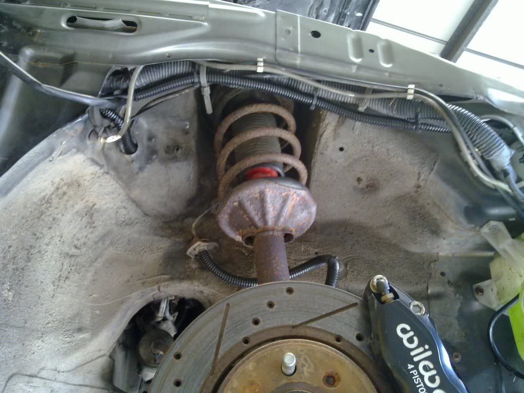

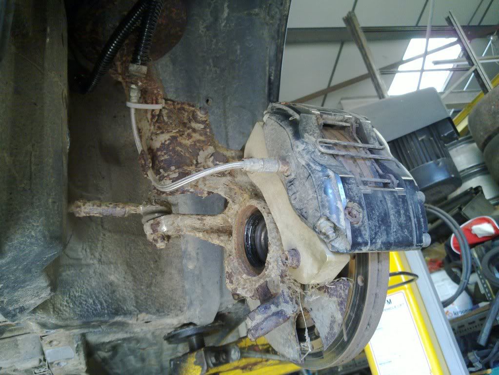

Car has been with Martyn (vss Irvine) for a short time now and is really taking shape. What a transformation! Seemed a sin to fit a pristine, newly furbed sub-frame, tie-rods, arb’s, uprated wishbones and Modena lsd without addressing other items that needed some tlc. As a result, the majority of the running gear was removed, blasted and powder coated or painted. Poly bushes a go-go, new wheel bearings all round, new drop links, new rear callipers. Even the nuts and bolts have either been replaced or re-furbished. I’ve swung by a few times and taken some before and after pics which I’ll post up soon. Once this work’s completed, the bodywork will get addressed. Martyn has a shell that will have the rear quarter cut off and transplanted to replace my fcuked one.
Some fiddling with the suspension geometry then it’s engine management time… need to fit and map to marry up with gt2871r, 660 inj, z32 maf and all the associated induction, exhaust, cooling mods. Have a wideband AFM with 0-5 volts output and 3 bar sensor to marry up to ECU. Looking forward to getting this car back on track!!!

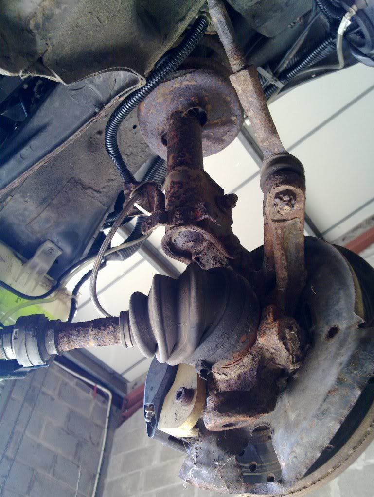

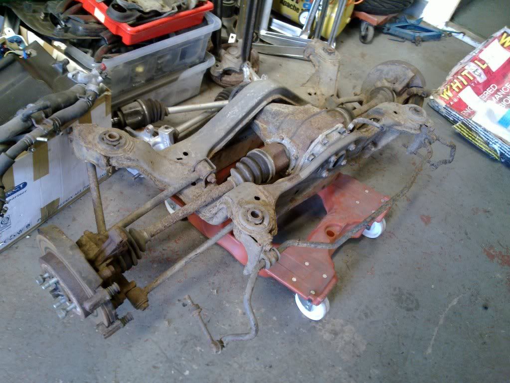

It's all coming together.... the before pics are embarrassing. :oops:
The parts that are going back on the car are very nice, well finished and well fitted. The improvements are mouth watering.

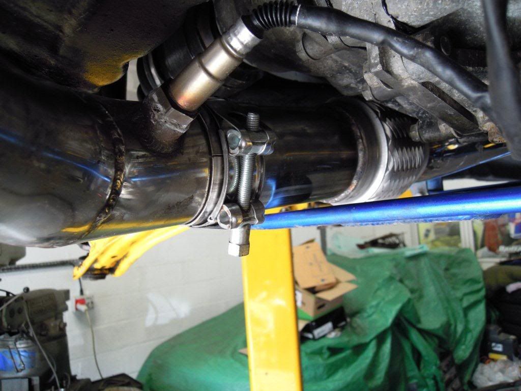

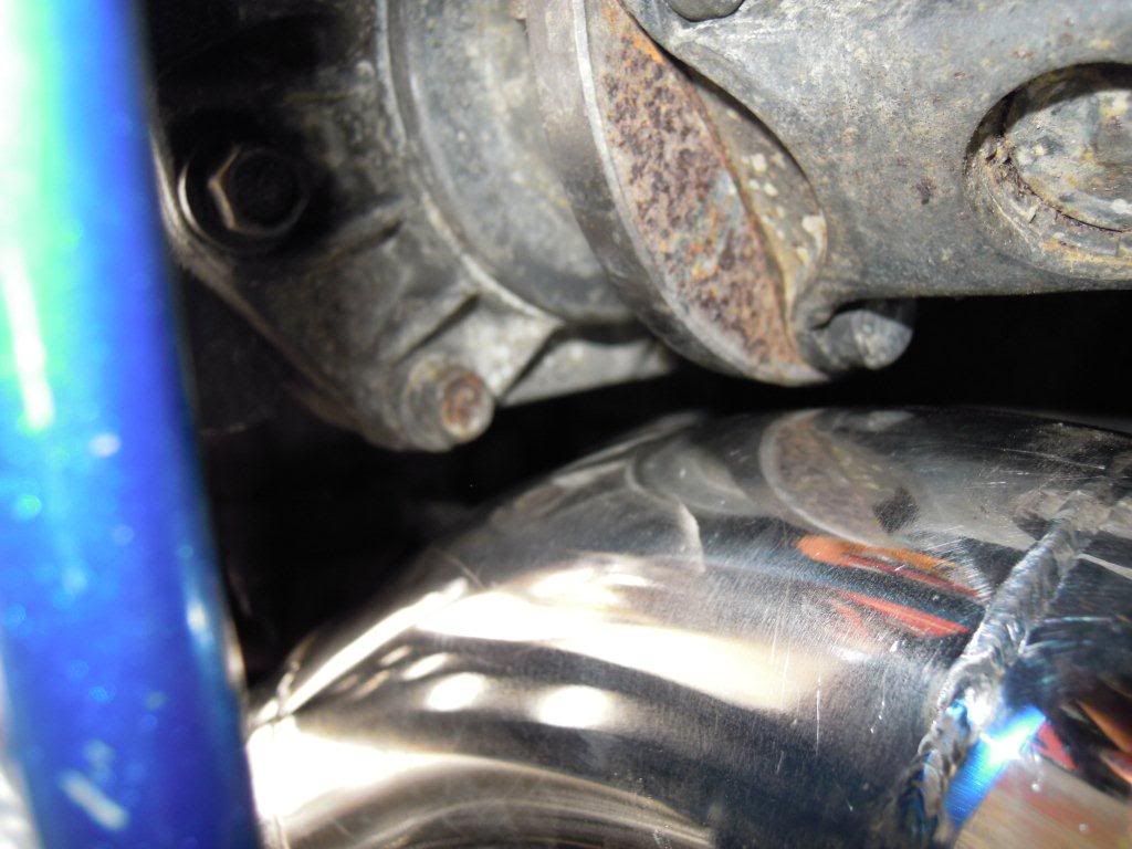

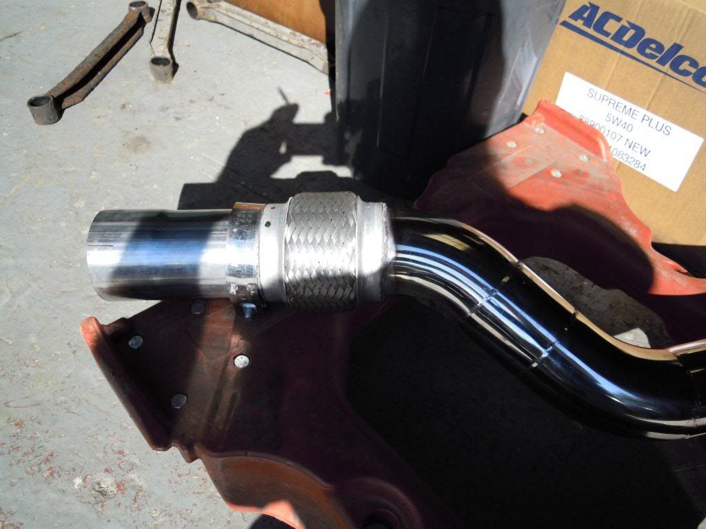

Martyn had to modify the exhaust in order to fit the brace. The AM Performance exhaust flexi was fouling the brace so that was cut off and replaced by a shorter flexi. I’m very pleased with the results!
I could rabbit on but it's been a long day... I'll post up some pics.
AM Performance flexi gone and relaced with smaller flexi.... also added 2 inches as the AM pipe was a tad short. It was a bit of a ball ache but the results are sweet!....
Modified pipe in place under lower front brace... :thumbsup:

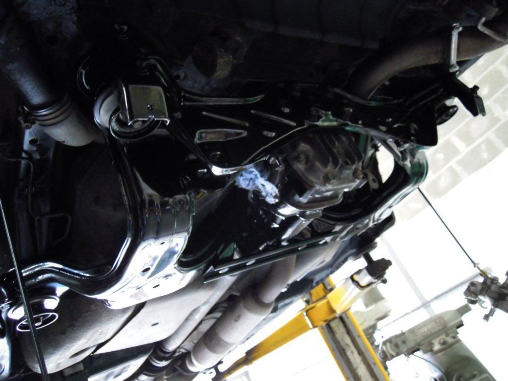

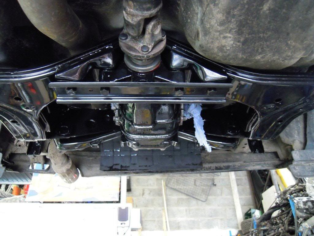

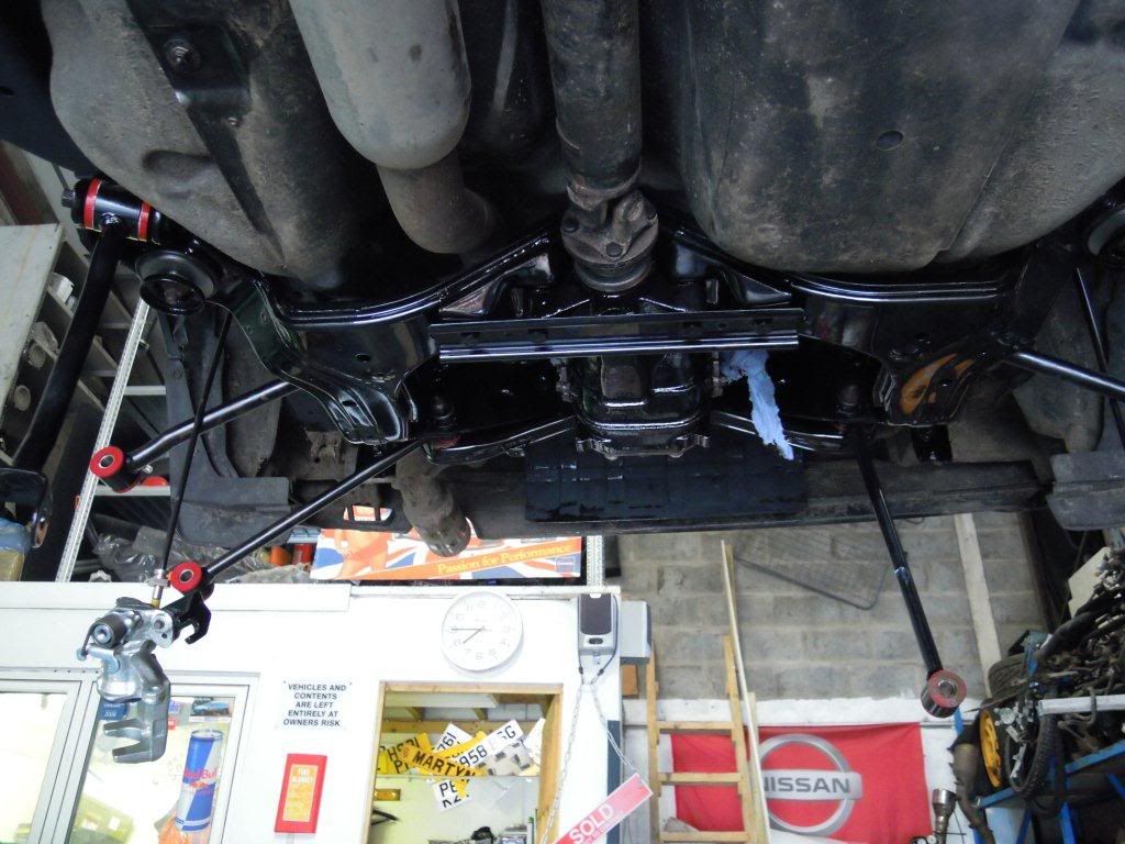

Rear sub-frame and diff going back on.

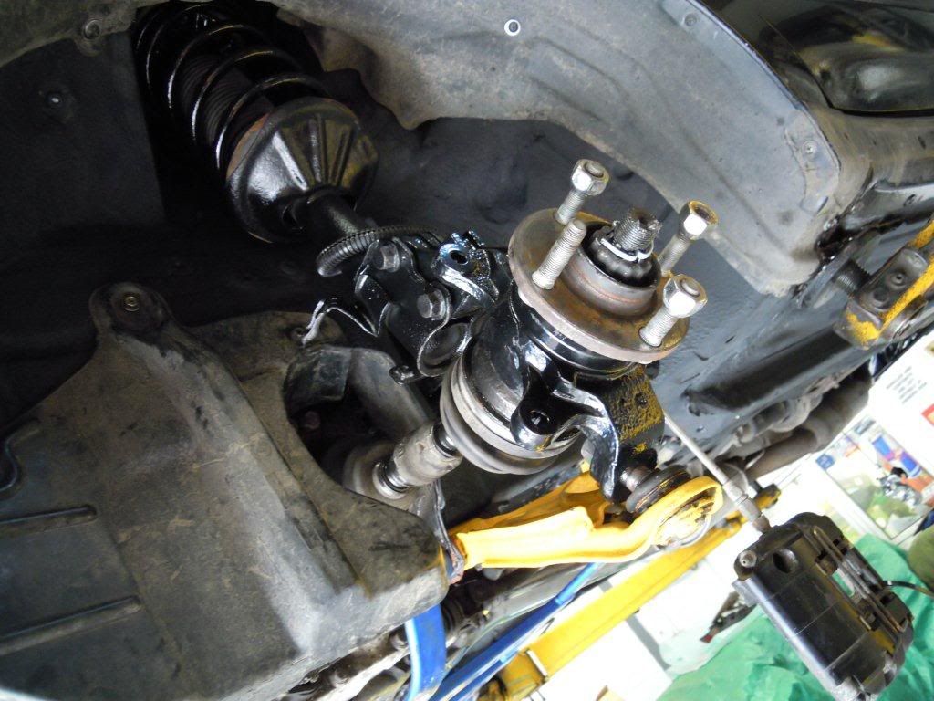

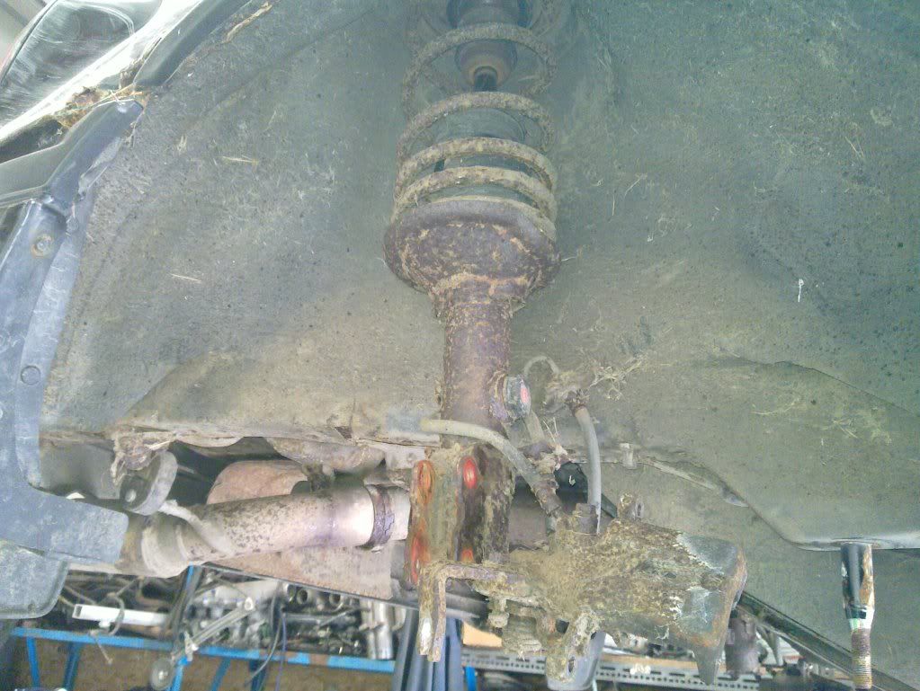

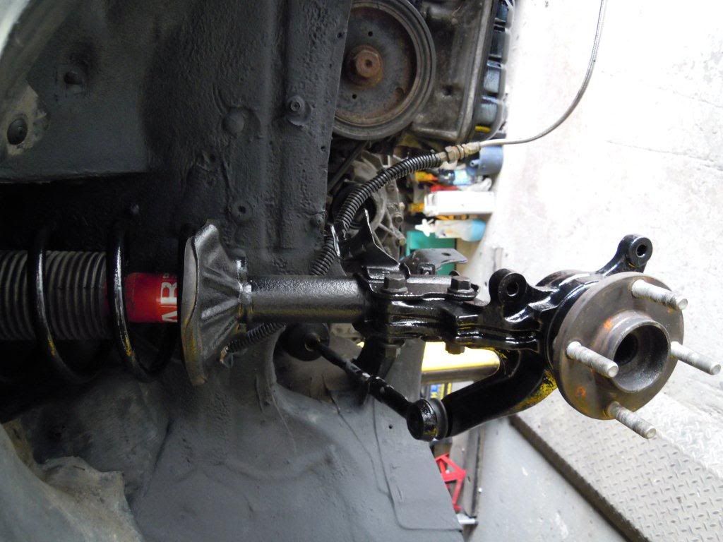

Front Strut, wishbone and hub fitted.... mud, shit and rust gone.... :lol:

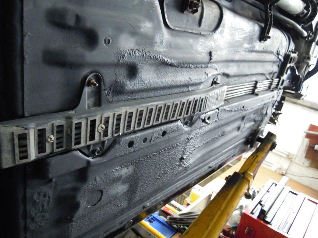

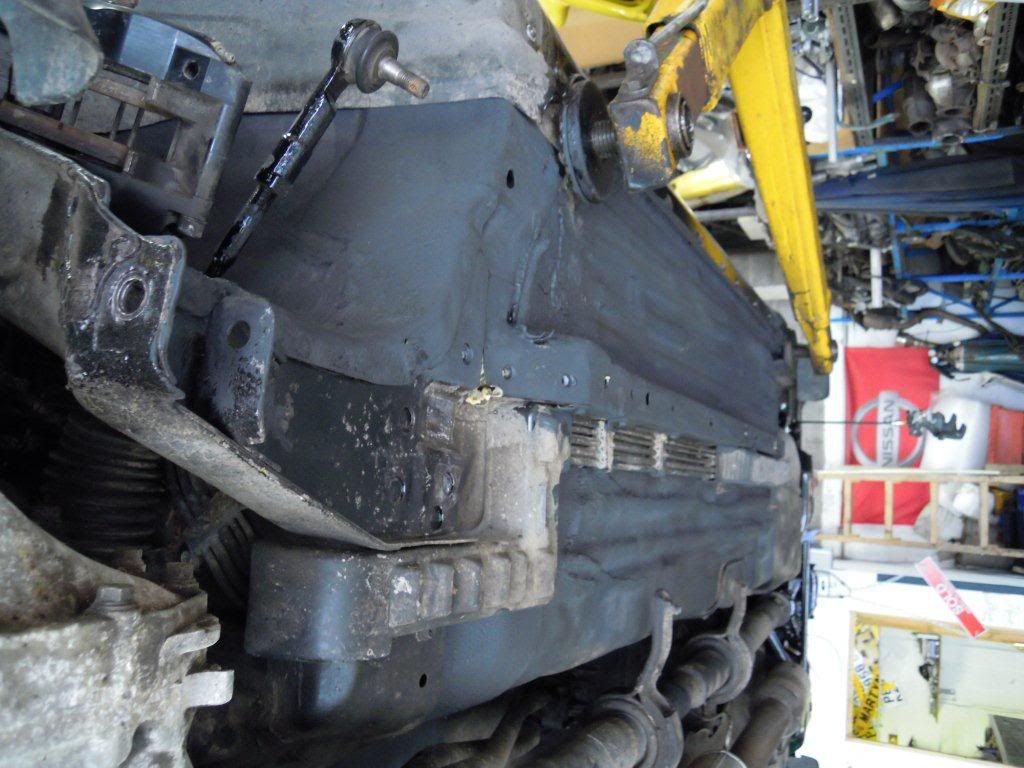

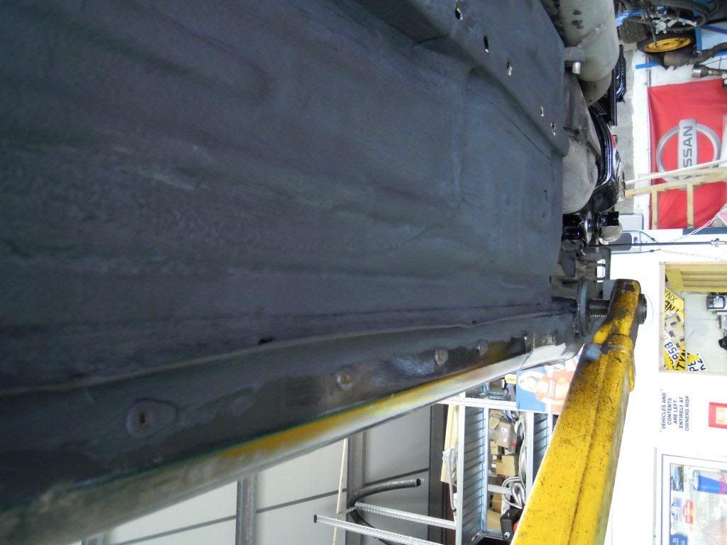

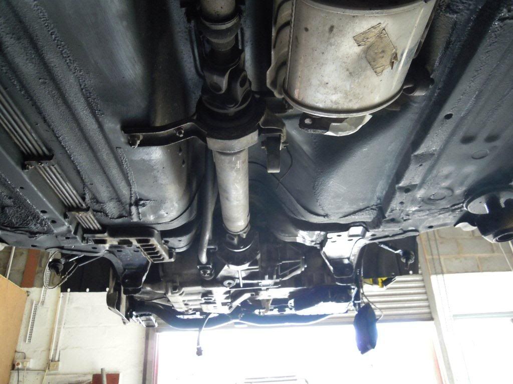

Underside got a tickle of stone guard while parts were off.

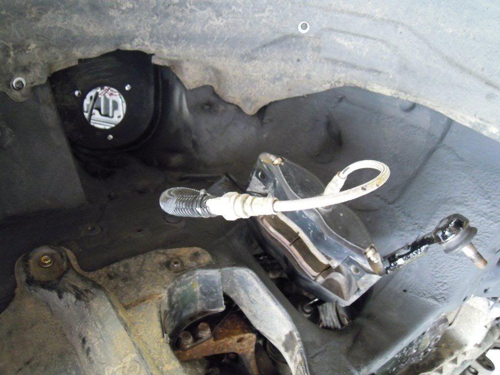

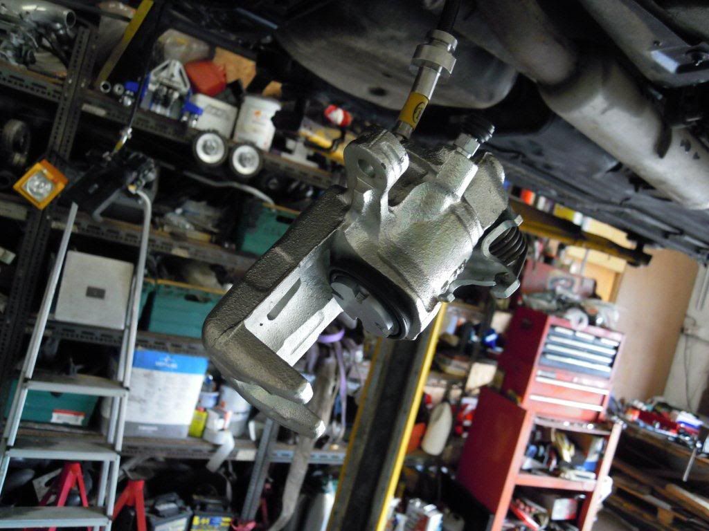

New rear callipers.

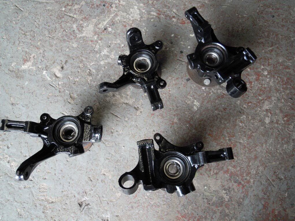

Hubs blasted, powder coated and fitted with new bearings.

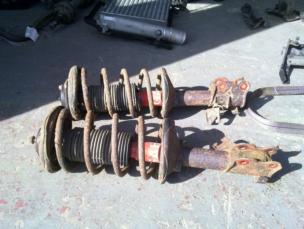

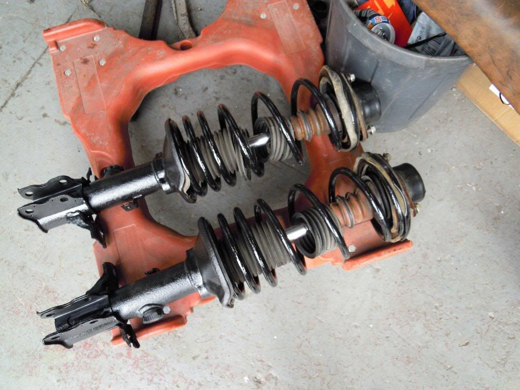

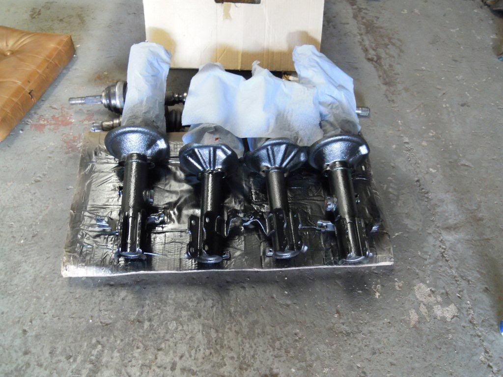

GAB struts live to fight another day!

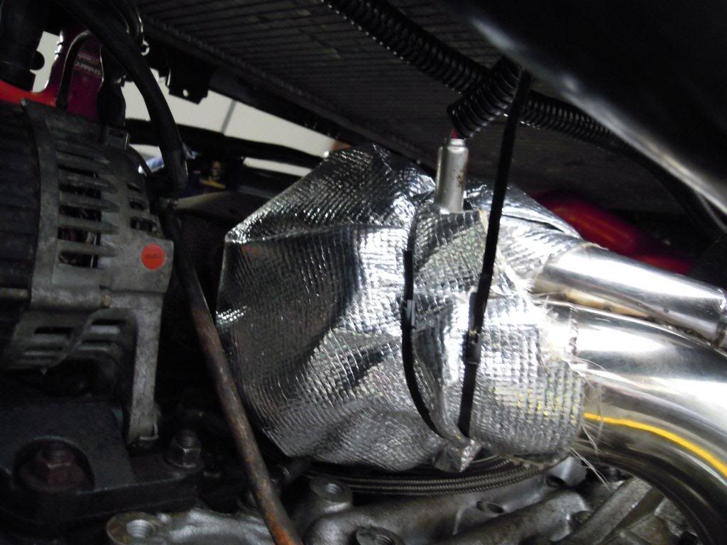

Turbo gets a nappy.
