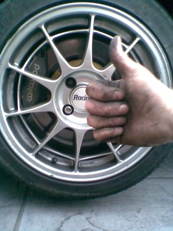

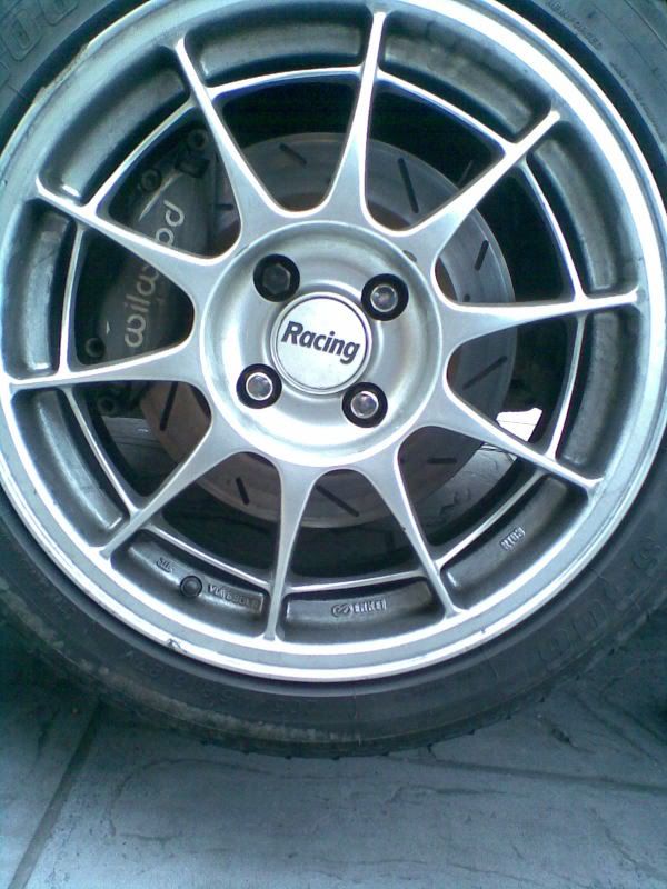

So in short you can upgrade from 280mm kit to the 310 with no problems
The 310mm kits comprises of two longer calliper bolts and a couple of poly washers used as spacers
After that its jut the 310mm disc and spacer ;-)
If anyone says that they don’t fit or the disc "won’t fit" or "the callipers due to having a different internal size where the pad sits" is a load of crap.
Everything fits and just to confirm 100% I used DanDuds 310mm disc, washers and bolts on my car and they fit perfectly using my 280mm kit Midilites.
280mm kit
310mm kit
Easy ;-) 8) :-D

Yeah pretty much! All that is different is the threaded bolts which are longer (around 3" long) that connect the calliper to the yellow/gold coloured bracket and a pair of poly washers (one pair for each side) that are used as spacers
Then its a case of the removal of the old 280mm disc and replace with Wilwood 310mm disc and bell :thumbsup:
If someone has a 310mm kit perhaps they can measure the bolts and washers for 100% accuracy, other than that just make a quick call to rally design to order the 310 upgrade ;-)
