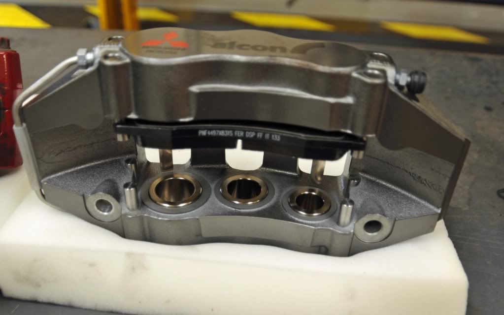

If the pads are wearing tapered along the length of them its more than likely down to the piston arrangement in the caliper. I'm guessing all 4 pistons are the same size in your calipers?
More expensive calipers have differential bores to stop this happening. The piston the disc comes into contact first is a smaller diameter and the pistons then increase in diameter as you move along the caliper.
This picture probably explains it better.

cheers for the help peeps.
oh well woll just have to remember to keep turning them.
