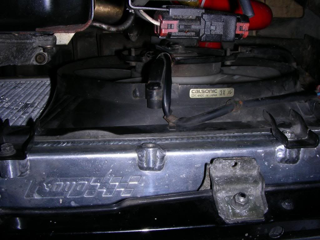

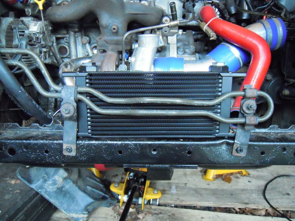

I have a Koyo 50mm alloy rad fitted and a 16 row setrab oil cooler and use Silkolene PRO R 15W-50.

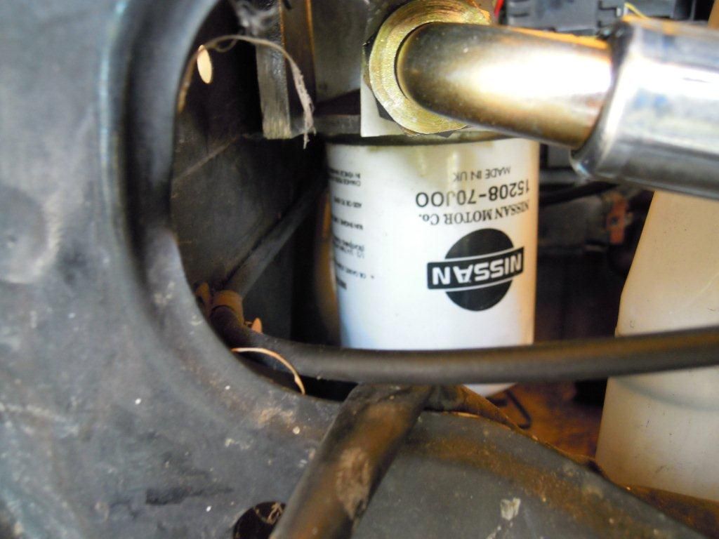

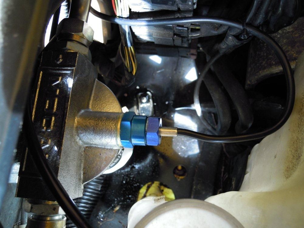

Run the oil pipes up and over via a relocated Oil filter and use a manual gauge to monitor oil temps.

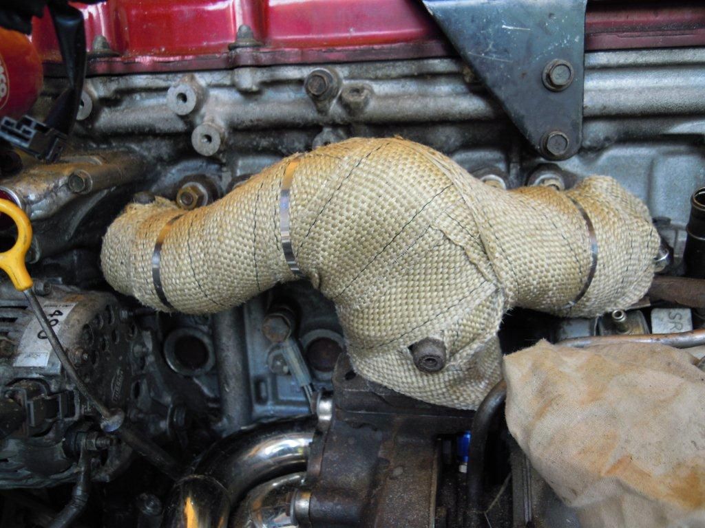

You were wondering about heat wrapping OE Manifold....

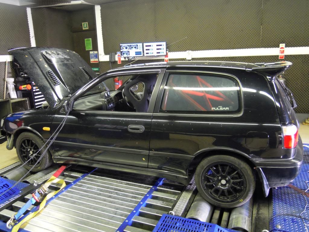

who maps your car for the bigger turbo, etc?
