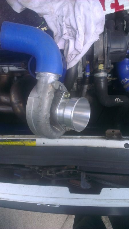

Did a bit more today. All thats left now is getting a short piece of aluminium tube to join the intercooler pipe up, sorting the actuator bracket out, and modifying the turbo inlet hardpipe.
It was a 200sx manifold until i chopped it up and added bits to make it fit a gti-r ;-)

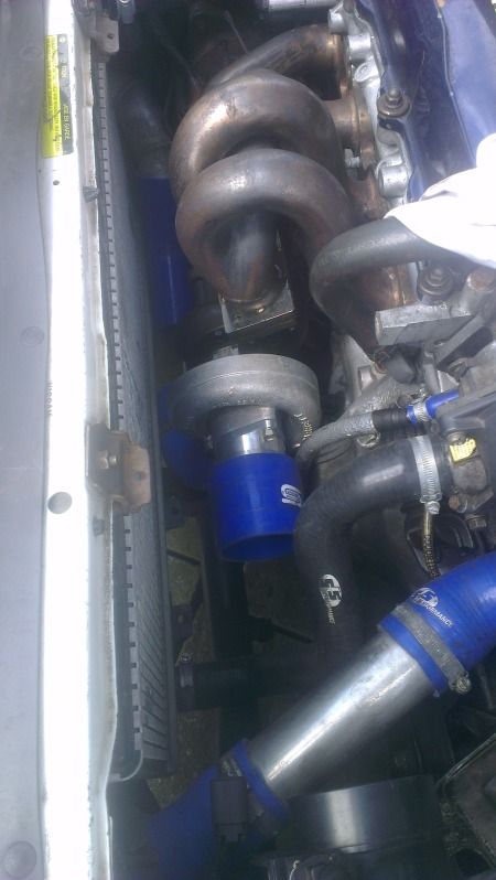

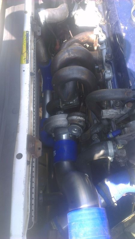

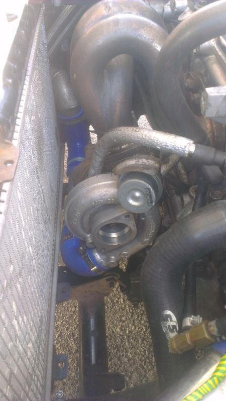

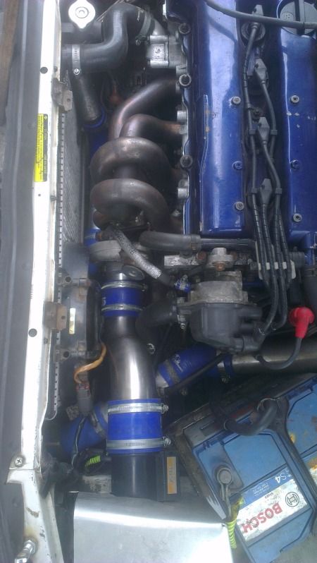

Got a fair bit done this week despite losing a few days away to work. I've tigged the turbo flange back onto the manifold, cut and re-welded the actuator bracket + the 3" inlet pipe, and made up the aluminium intercooler pipes.
Just need to pick up some hose clips for the intercooler pipes and some copper washers for the turbo lines and get everything bolted up 8)
Couple pics now its all up and running.
If anyone is interested the whole set up, turbo, manifold, 2.5" turbo elbow, 3" inlet pipe, braided oil/water lines, oil drain, Hks actuator and first section of the intercooler pipework will be for sale in the next month or so ;-)
