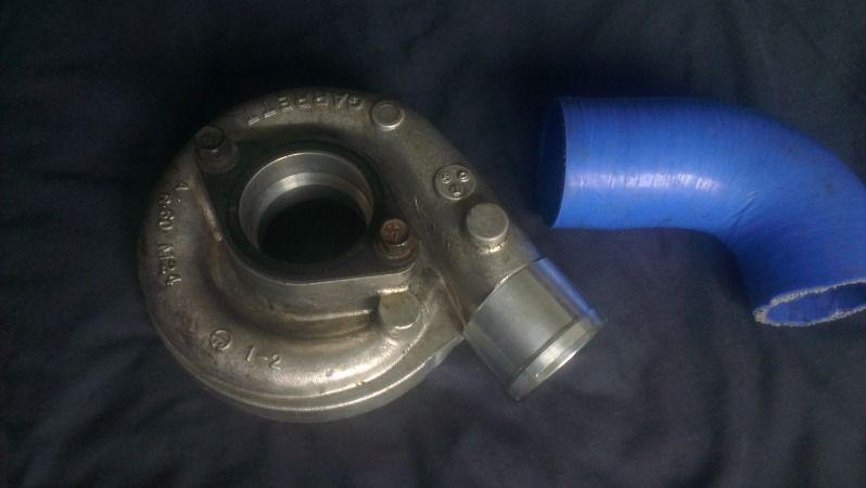

Does anybody know where i can get one of these in the uk?
I'm putting a standard T28 back on my car for now but need something like this as i'll be rotating the compressor housing to run the intercooler pipe downwards out the way of my exhaust manifold.

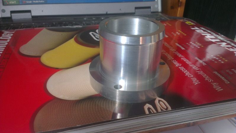

I don't know why i didn't just do it in the first place but i found a bit of scrap earlier and knocked this up. Didn't have anything bigger in diameter so the bolt holes are pretty close to the edge but it should do the job.
Just got to machine a few flats on it now and its finished 8)
I was being lazy and didn't think we had any big enough diameter bar at work to make it so thought it would be easier just to buy one :oops: It was fairly easy to make in the end but i've just run into the same problem whytie had in this thread :doh:

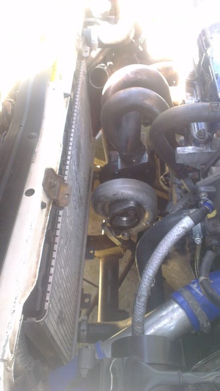

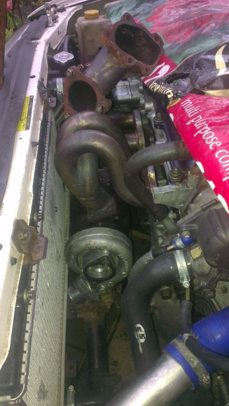

Sorted the stabilizer mount clearance problem now, i cut the manifold apart and moved the turbo upwards :lol: Theres still not a lot of room with the adaptor i machined up so i may need to try and find one of these, think its off a 200sx or a Silvia?
This is where the turbo sits now.
Hopefully i've sorted it now so can get on with other bits. I had a brainwave earlier and machined the flange off the top of the compressor housing so i can tig this bit on. That should just about give me enough room for a 90 degree samco straight off the turbo 8)
