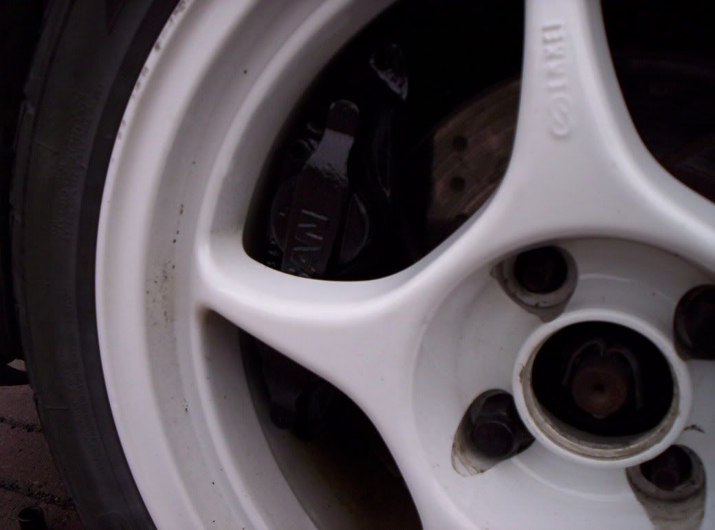

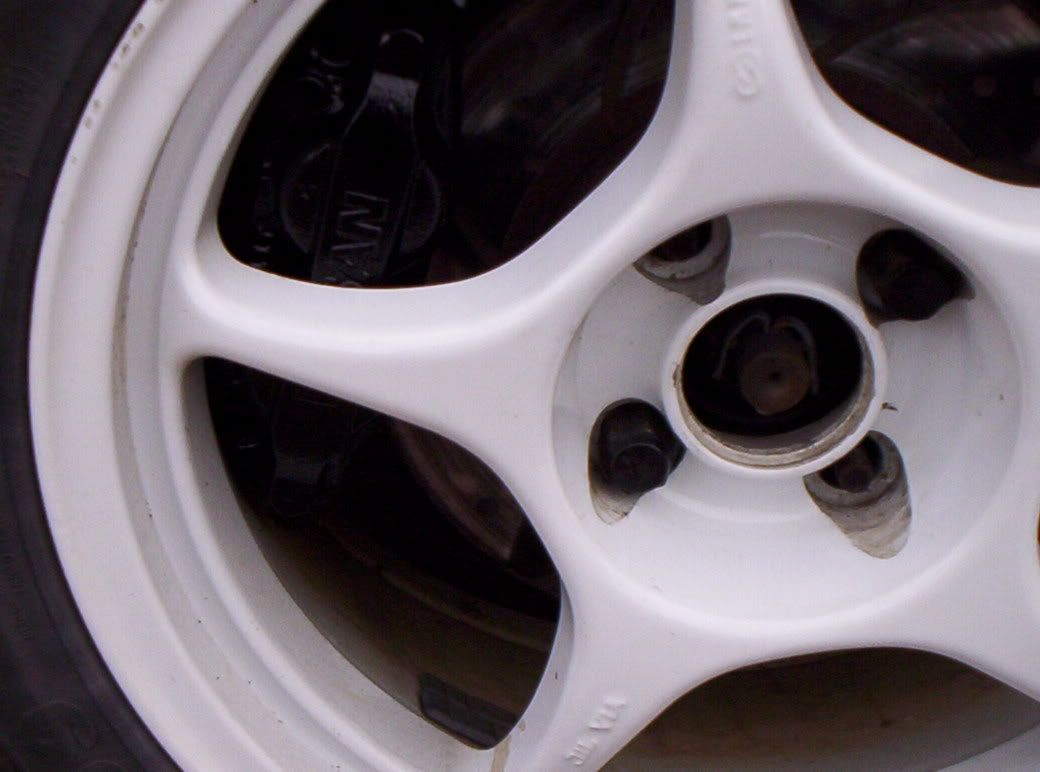

gtir bean
not the best pic but with my rough measurments the 320mm disks will fit perfect.there the same offset as the standard disks too.only problem is the calliper will hit my 16's but they should fit ones where the spokes dont curve in at the ends.

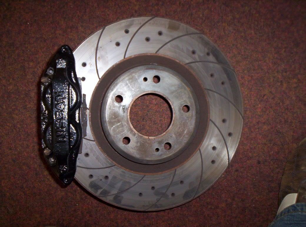

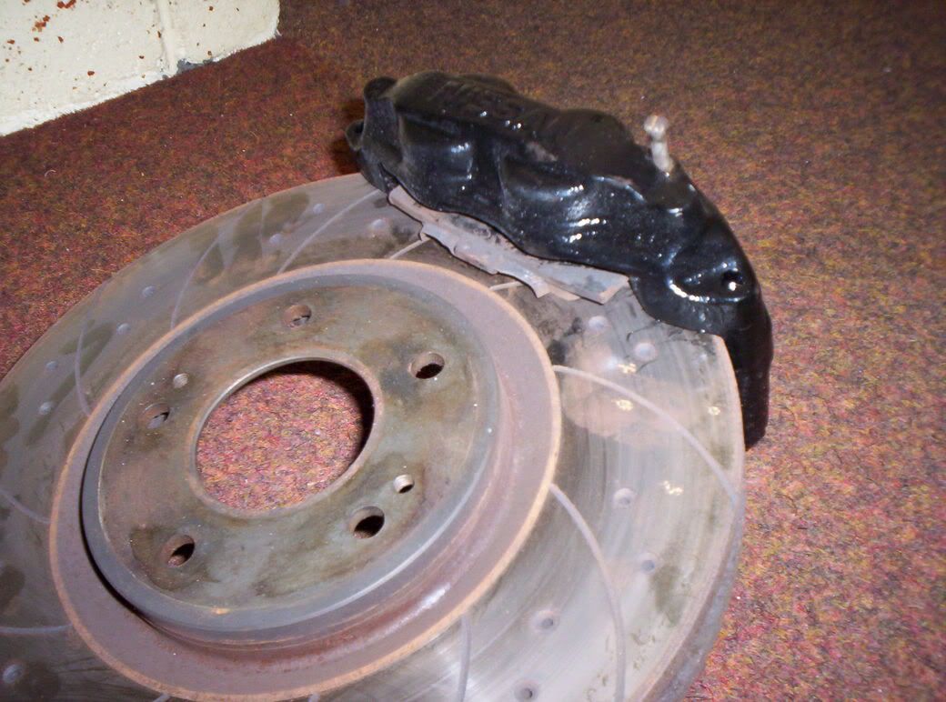

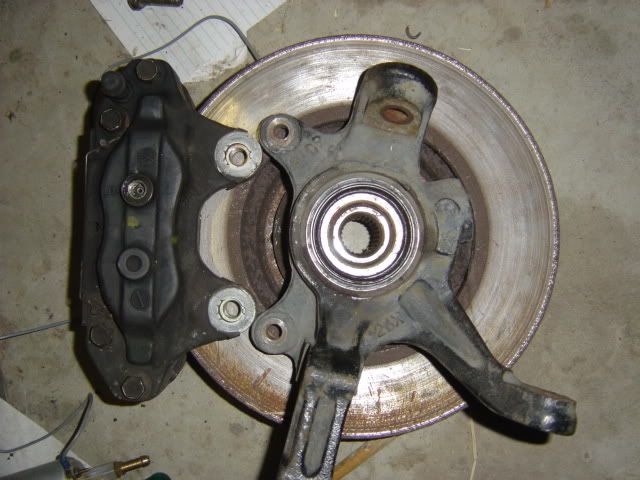

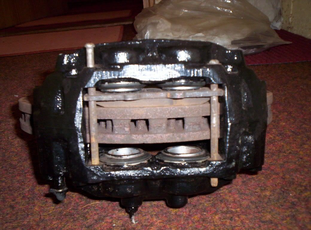

SR910
Hi, i hve nearly complete this brake conversion to my gtir, i used R33 calipers (just uses a bigger diameter disc) but i used U13 bluebird hubs, for the reason that they have the 100mm spacing and have the same geometary as the gtir hub. The only problem if they run a larger diameter CV spline, so you must also run the U13 CV.
here are some pics
here you can see the problem, no way you can get the nissan 4 spot close enough.
here you can see the spacing difference in the hubs
you can see the R33 caliper bolted up to the hub, the standard r33 disc is used, 5 mm taken off its radious as it is slightly too large. Discs redrilled to 4 stud.[/img]
