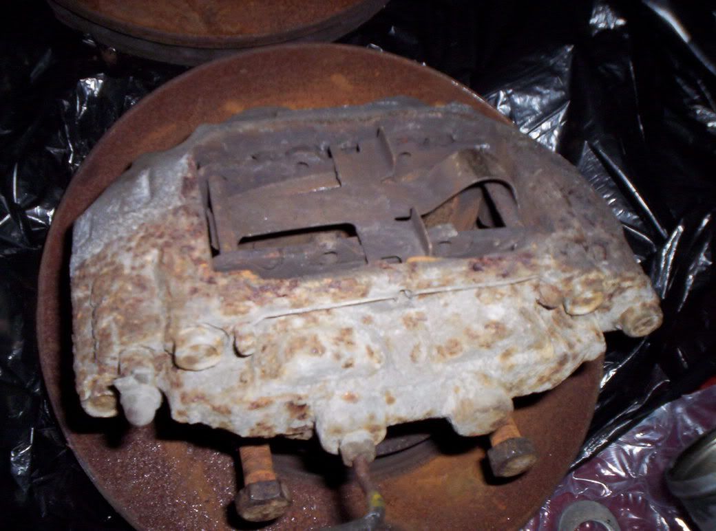

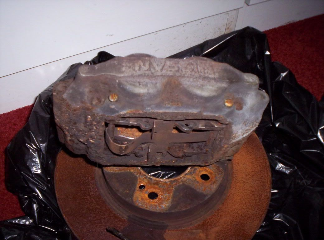

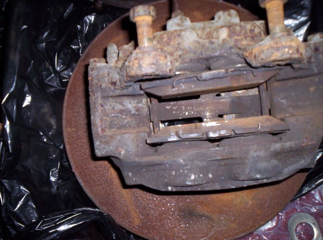

this is how they look at the mo,not very pretty but once there all clean and painted all will be good.[/img]

I have to admit looking at the state of those calipers I wouldn't even consider putting them on a car. They look well past it. :(

How do you know the seals are ok, looking at them, theyve been left in the rain, or in the garden for a long time
gtir bean
there is no evedance of fluid leaking and the dust seals are all ok and the pistons move free.i removed them from the car so its not as if they have been lying on the ground for a while.if you look at brakes on any m reg uk car they will prob look like this unless they have been painted.
