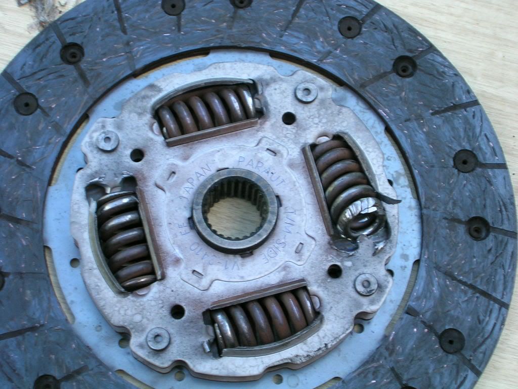

Daz's car's managed to do this to an AP kit, an RPS paddle and an organic plate now. Very strange it keeps munching plates and it's always the PP side not the FW side.

you see the problem is that i have now found out is that rps and the likes use a STANDARD clutch plate and uprated cover this to me seems no good what so ever. call me a liar if you want but the thing is i have proof lol. you see due to all the clutch grief i have had i had to get a clutch there and then so i call my local motor factors who just happen to keep quint and hasel clutches in stock for the pulsar. when asked what sort of power or torque these are rated at was told that the clutches are based on the oem unit. ok you say. get the new clutch out the box and the clutch plate itself is EXACTLY the same as the rps so called uprated one ie same materials and the same numbers on the cover basically the same plate as this one. and the price was £141 instead of the £310 for the same clutch with a modified double sprung cover.
so basically that picture you are looking at is a clutch plate that cannot cope with the stress its under and forced the springs through the metal of the plate. because it is an oem item basically. and just for the record i have had to replace all these clutches myself bar one because these so called failures are down to abuse or wrong fitment which in my opinion is absolute rubbish. and just for the record this clutch was fitted before the clutch was wrongly adjusted and the clutch was changed before so therefore was not over stressing the clutch cover springs. the thing that winds me up the most is that no one is willing to accept that there clutch has failed. and just to correct you dan it keeps munching the springs and the metal surrounding them as you can see from the back or flywheel side of the clutch

Yes that's 100% true that RPS, Exedy etc etc use an OEM organic plate with an uprated PP.
What's your point?
It doens't change the fact that your car is the ONLY car that's managed to have a failure of not only an AP kit, but then not 1, not 2 but 3 RPS kits. All exactly the same problem.
How many other RPS failures have we had with SR20 kits? NONE
Somehow you're overstroking the PP fingers which is nothing to do with plate itself or the clutch kit. It's something else and needs attn to find the cause, not just shove another kit in there Daz, that won't solve the problem at all.

look im not wanting to cause arguements or anything else ok before this gets out of hand and at the end of the day dan how can over stroking the fingers push the springs of the plate through the clutch ???

Cos a stock type plate lasts longest and it's not the plate that does the work, it's the PP
So when the plate ingauges the flywheel at 7500rpm on a 350bhp engine it's not doing any work then :? .
Explain that one to me please fella :? :? .

Well it's not is it really. It's just sat there being pressed against the FW by the PP in the cover.
Come on mate, it's a well known fact that the PP is the part doing the work, the plate is just the difference in how the clutch engages.
and it's worth noting that although the plate is a stock type is doesn't mean it's come from Nissan. If anyone wants to look very closely at an RPS organic plate, you'll notice one thing is very different in that they use flat head rivets to hold the material in place, where most other plates use round head type. Bonus with flat type is that it allows a little more wear before the rivets are hit
