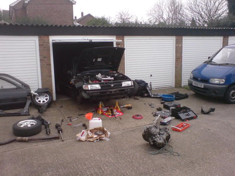

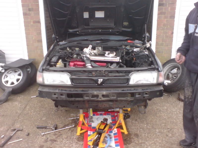

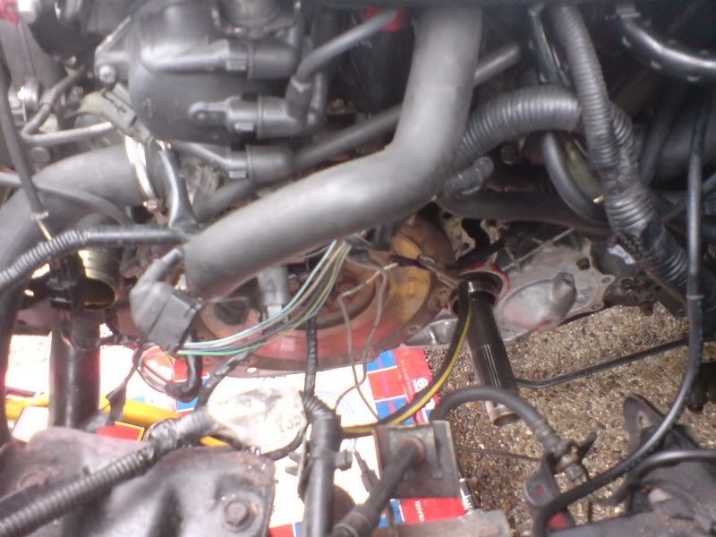

Anyone got any more pictures to help me with getting the box off?:thumbsup:

Keira said:
you're obviously a smartarse aswell then shaun ;) :lol:
I am at that Kieron ;-) It all comes down to abit of Quantum Mechanics and being able to be in 2 places at one time:lol: .Oh and i do the Hulk bit all on my own:lol:
j10gtr
Never seen the box removed like that. You undone the nearside mount and tilted the engine to give clearance ?
Paul
Keira
theres abit more to it than that, but essentially thats all you do, get everything out the way with the engine bolted up as normal, we then take off the transfer box end case and pull the front diff out (its been put back in the last pic), you have to be careful not to split the middle plate from the main case of the tf box, shaun and a few others drop the whole transfer box. You need to do either as the box wont slide off the connecting shaft of the diff before it hits the chassis. You then support the box/engine, whip off the mounts and lower the engine on gearbox side, and simply pull it off..
peice of Pish if you know where everything is and what size sockets to use, can be on the floor in 2hrs tops. I'd imagine its not so easy if you dont know what you're doing. Better off dropping the lot if you've never done one imho
