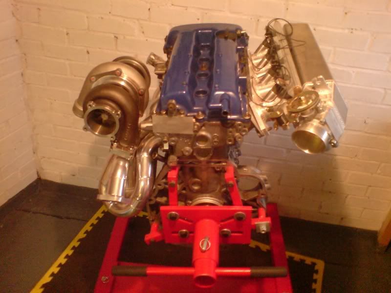

Using engine stand.
Hi folks just one question. Has anyone got a picture of their engines on an engine stand. I will be getting one soon and it looks like most if not all the threads are in the gearbox.
Mark
noriek2003
heres mine. i use the gearbox bolts and one bit of threaded rod.
machine mart jobbie, the more expensive one, the cheap one is ok but abit kak imho. this one is much more stable.
dobby
Cheers that is were I am getting one from. I know the one you are on about
