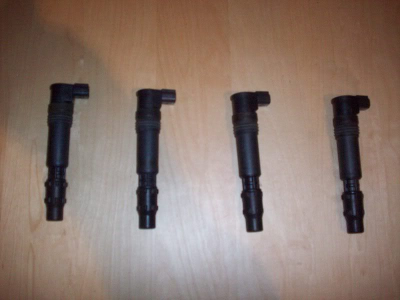

Here K I was told a good way to go is COP with say CBR coils rather than wasted spark, did you consider it?noriek2003 said:my mistake :doh:
i was talking about wasted spark set ups as ed has pointed out, as thats what i will be running on my gtir. Afraid to say im to used to worrying about my own set up, last time i concerned myself with a gtir dizzy was to look at taking it apart to only use the cas part of it. I was even considering selling my full set of gtir manuals in the week as they are about as much use to me now as tits on a fish :lol:
I am gona guess its because you have 2 coils and more charge time between them giving a stronger spark at higher rpm'ssteve963 said:i'll 'HAVE' your manuals lol
why you gonna run wasted spark?
i'll be using the cbr coils ;-) they are the bollox, proven on 1000bhp + cars, no spark drop out at high rpm, will still give a spark at lots of boost, cheap aswell if you find them in the right place 8)jpward said:Here K I was told a good way to go is COP with say CBR coils rather than wasted spark, did you consider it?
	I am thinking about going similar route with the AEM but it seams a lot more cost although you do have a more precise ignition.noriek2003 said:how much are you willing to offer me for them ? all 3, original workshop manuals ? very good condition, like rocking horse poop now, pm me if you'd prefer.
why will i be running wasted spark ?
standard dizzy based set up will not be up to the job on my car tbh. The standard dizzy/coil set up is not going to generate a good enough spark at the cylinder pressures or revs i'll eventually be running at, not with anything resembling a decent plug gap.
i'll now be running the m&w pro12 cdi unit with honda cbr coil on plugs 8)
Originally i was going to use a different ecu to what i have now and would've needed a crank trigger and cam phase sensor to run fully sequential, which tbh, i couldn't be bothered with, annoying thing now is with the motec i could be running full sequential ignition and injection for only slightly more money (different cdi required)
what i have will be more than up to the job so im not going to lose any sleep over it now tbh.
noriek2003 said:i'll be using the cbr coils ;-) they are the bollox, proven on 1000bhp + cars, no spark drop out at high rpm, will still give a spark at lots of boost, cheap aswell if you find them in the right place 8)
the cdi unit i have will only fire 4 coils, regardless on whether they are on the plug or not as wasted spark. (as ed pointed out, of the paired cylinders, 1 fires on intake, 1 on exhaust) I chose the pro 12 as the ecu i was planning on getting required lots of messing about to run sequential (crank trigger, cam phase sensor). With the motec its alot less hassle :doh: so could've gone with the pro14 that would then run sequential, but never mind, it'll do :lol:
