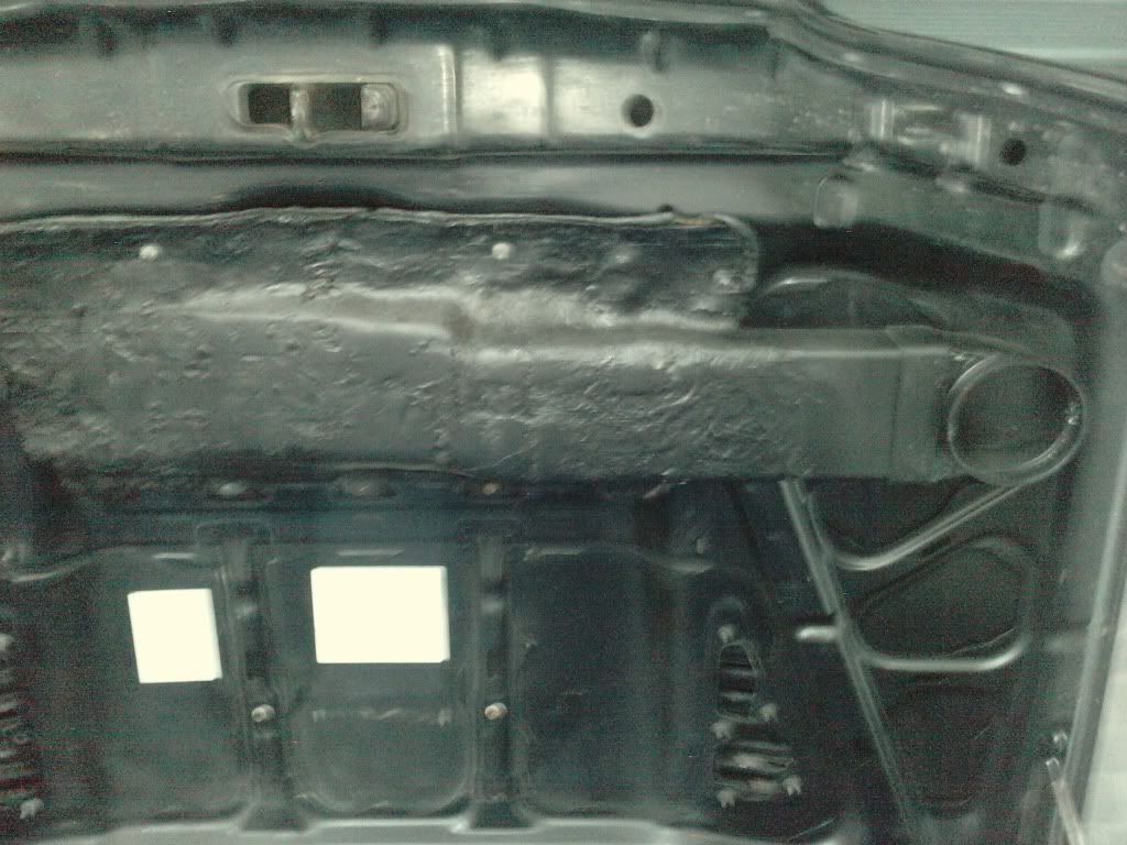

I made this up from fibre glass, chicken wire and some domestic ducting, forces the air drawn into it right over my air filter instead of the manifold.

Outline of the bonnet has to stay the same, I get away with a smooth scoop as the side view is unaltered. I then have run it either blocked or I now feed air over to the air filter. (simular to the idea above) I also run my small vents with a lot more flow than the standard ones.
Thats something i'm looking at doing. At the moment my air filter is boxed off and fed from the inner wing but feeding it from the bonnet vent would give it maximum cool air.
They sure do, mine might look crap and not a patch on stuff people like Phil can make, but it works brilliantly and the filter is actually cold when you pop the bonnet after a run and feel it.Other peoples get really hot.

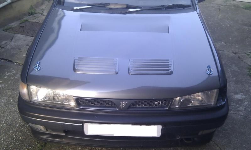

My cus has a custom grp bonnet, flaps a bit as well on the motorway at speeds of only 80mph +, got to 130mph once and backed off. The thought of it pulling up and smashing into the windscreen is scarey.
As you can see it has vents cut at front and rear.
Another option.
Phil does yous go into a cold air box or just onto the filter?I used to have it feeding a box but no room for it now so cardboard is filling in for now until I cba to make a better job of it.
bracpan
I have made a surround that patitions off the filter ( its not a complete box) and the pipe then exits on top of the filter, I belive it works as the filter get dirty right under the vent..
