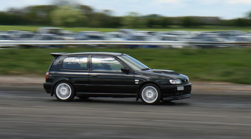

Good pic that carl. My taped onto strut brace camcorder in car worked. Its been great to listen to the slipping !!!!
