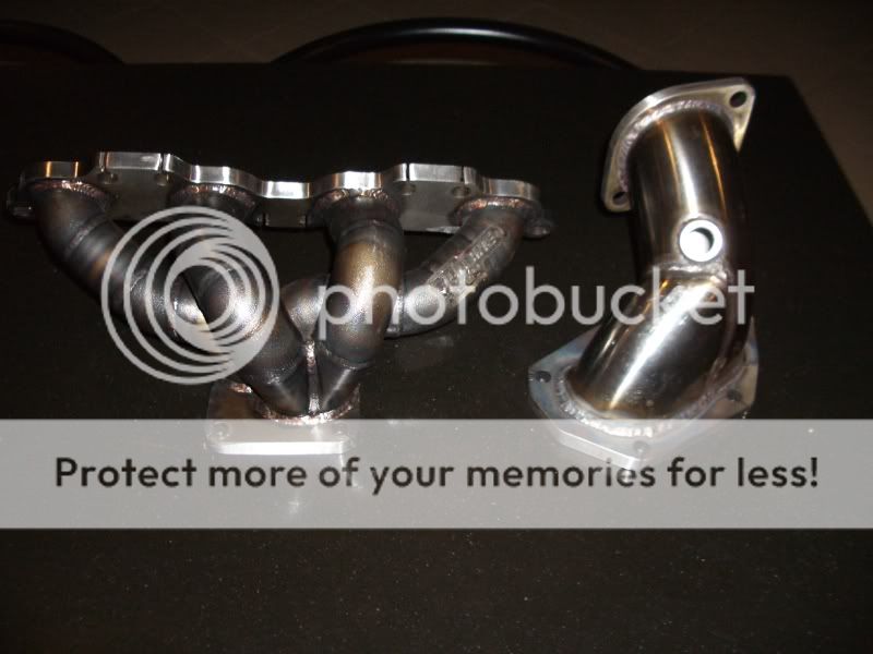

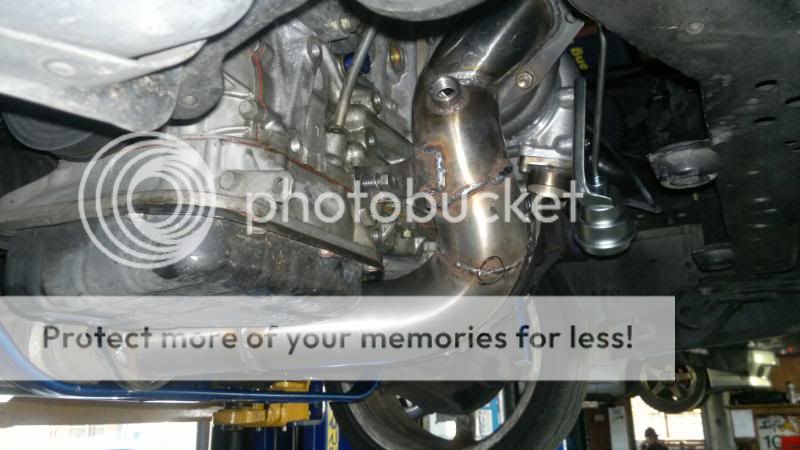

The dump pipe was also made by Turbine Tech.

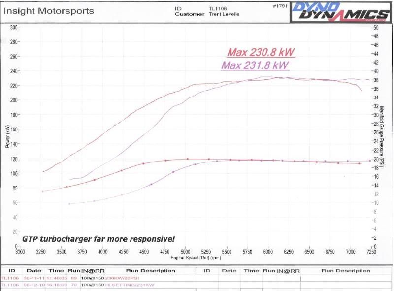

The dyno graph is when I changed the turbo from a standard turbo rebuilt to 2871r specs to the Evo manifold/turbo. Long story short this turbo gave me 50% more power at 4000rpm alone without losing any from the top end. Once I get the new dyno sheet with the current set up I'll post it up.
Tuner said this week he's never done a GTiR with such good bottom end.

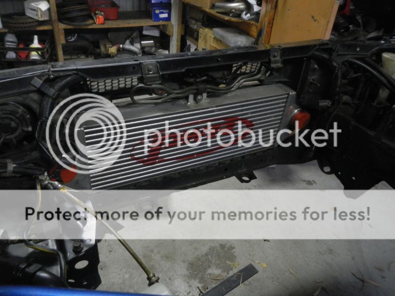

Intercooler
Dump Pipe
Manifold and dump before ceramic coating
Old dyno sheet
