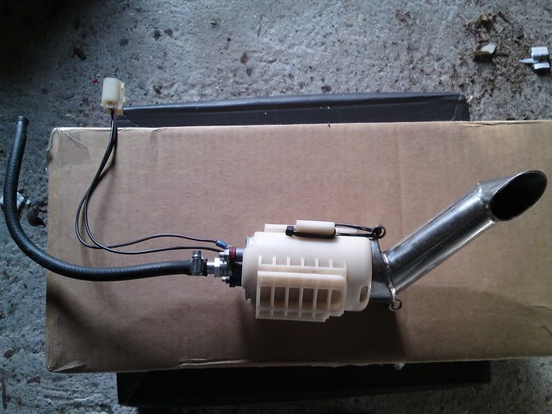

darren....i had one of those pumps (sold it to pesh90) think thats the one your talking about with custom fabricated tube. it supposedly came from a skybarge that was running over 600bhp and it is one powerfull little pump if you adapt the end (maybe a little too powerfull for whats needed really) thats why i flogged it
Cheers Bob I will search him to find the pic.

is that the pump that was removed from your car?
if so then its exactly the same as the one i sold to pesh!

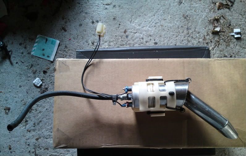

No this isnt my pump ts the one you sold its the same as mine but has the spout added.
Not gonna be doing any track days until march-ish so keep me posted on your test sounds like it would work I had a baffled sump on mk2 escort that had windows and flaps in the baffels that worked the same way.
Im gonna run the walbro for now and keep the bosch one on the bench to make some mods to before it hit the track
