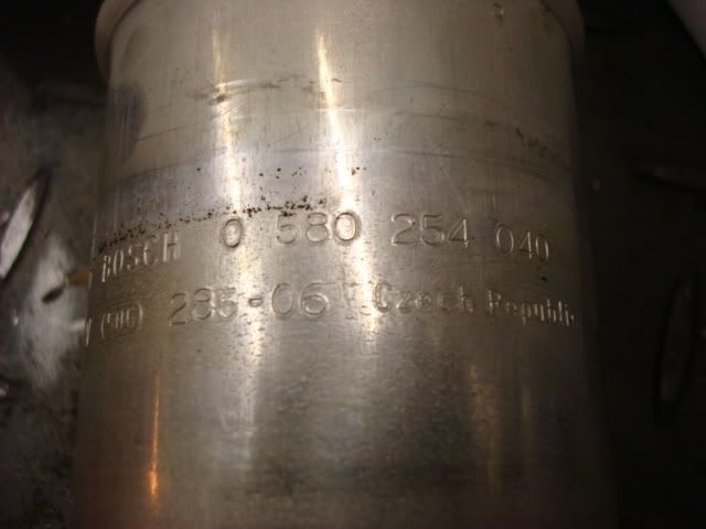

Ive just pulled this Bosch pump out of a car and have a recipt from Norris Designs saying its a GRP A fuel pump.
Its a Bosch pump just wondered if anyone knows if this pump is better than a Walbro?
I have both and want to fit the better one to my car.
See pic with BOSCH numbers.
stumo
It's the same pump as an 044 but has the base as the intake, not the best pump for the R fuel tank but it's a much better pump than a walbro.
eastwood
Yep thats it the whole base is the intake no pickup or bag I assume this because the pump isnt submerged into the tank enough resulting in fuel surge.
I think I saw one before another member had with an additional alloy pickup but it was a fabricated pickup.
So I guess its either make sure you Ive got plenty of fuel in or the walbro?
stumo
I'd find a way of using the pump TBH as you still get fuel surge with the walbro.....

identified numerous Bosch 040 (intank), Bosch 044 (External or intank), and Bosch 984 (intank) which I run and never had one ounce of problem, and all for at least half the price. Somebody makes a nice profit from "seen them coming" customers.
